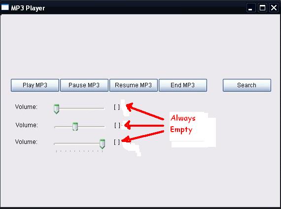

Sorry... What is the problem?esgici wrote:Thanks a lot MaestroRoberto Lopez wrote:
Volume property works perfect.
As always, problem resolved by the hand of master; the question of Mustafa answered.
And unfortunately, my problem left unresolved:
Best regardsCode: Select all
@ 180,100 SLIDER slider_1 ; RANGE 0,10 ; ON CHANGE { || Form_1.Player_1.Volume := Form_1.Slider_1.Value * 100,; Form_1.Label_2.Value := "[ " + ; PADL( GetProperty( "Form_1", "Player_1", "VOLUME" ), 9) + " ]" } @ 180,230 LABEL label_2 ; VALUE "[ " + PADL( GetProperty( "Form_1", "Player_1", "VOLUME" ), 9) + " ]"
Player example
- Roberto Lopez
- HMG Founder
- Posts: 4023

- esgici
- Posts: 4543
Re: Player example
Sorry, problem is that Get/SetProperty funcs doesn't works properly for VOLUME of PLAYER.Roberto Lopez wrote:
Best regards

'Volume' property is write-only.esgici wrote:Sorry, problem is that Get/SetProperty funcs doesn't works properly for VOLUME of PLAYER.Roberto Lopez wrote:
Best regards
- esgici
- Posts: 4543
Re: Player example
Thanks for clarification, MaestroRoberto Lopez wrote: 'Volume' property is write-only.
Best Regards
Viva INTERNATIONAL HMG

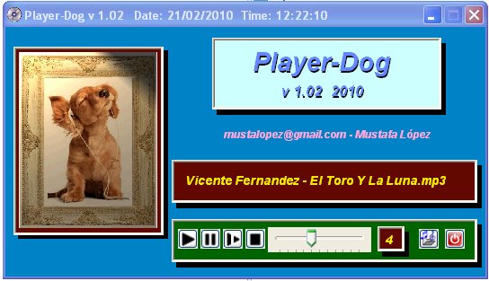

Hello friends
Here I leave an application for entertainment when
work on your computer you like listening to music?
For here you have an application built on Harbour-HMG
it also serves to listen to MP3 songs

- mustafa
- Posts: 1174
- Location: Alicante - Spain
Re: Player example
Hello friends
Here I leave the problems that I could not overcome:
When you press button "Search MP3 Song" is a TAB
Browse with two one is the path where is located
in sound file and the other is Browse to see only the
Song title.
When you delete the songs from the Databases
Browse through the Refresh and loading new songs
or incorporate new melodies, not visible in the Browse,
No record, but if he leaves the TAB and enter again
see them. (I have not been remedied)
In the "Play Button Song" is the button that starts the first
and Song and Through the help of friend Lucho Miranda ElSAlmes "
has ensured that the songs are heard in succession, I have not
succeeded fully in the song title and song
being listened match is an issue that if any of you
can verify this and find some solution to me indicates.
Through this routine is typically used for CPU intensive
of 98% reached INKEY (1) is reached 01 to 10 % believe that
is acceptable.
The last issue is the cursor "Finger.CUR" which already pose
in the Forum and the Master Roberto knows, is an unfinished
agenda.
http://hmgforum.com/viewtopic.php?f=5&t=1182
Cursor is on the arrowhead and when you want to press
a button appears hand Minigui Extended In the routine:
SetHandCursor (GetControlHandle (Button_D01","Form_1X"),"Bmp\Finger.cur")
But with HMG fails and if we put:
No effect.
I hope that in general hos like and if you can provide some
modification on the mistakes I've found would be useful.
Greetings
