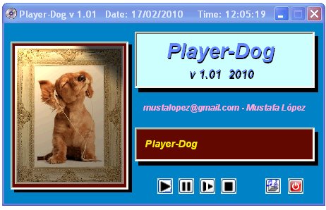

Hello Master Roberto
With Open File routine that sent me the other day
and the Post to publish on Mobile Signs
they both liked.
Mobile Letters
http://hmgforum.com/viewtopic.php?f=9&t=1166
I took the license to do an application of
research which combines the two concepts
Names I've found that moving can be
titles of the songs I've put two words
if you are not listening to any song just goes on
program name, but if we load a song
first one leaves the name of the Mp3 file you want
listen and then leaves the Advertising Program.
We must be careful if altered over advertising
Two of changing the number of posters that will follow
nCt: = Iif (nCt> 2, 1, nCt) replace a
the number you want if there are 4 posters for example
then would be:
nCt: = Iif (nCt> 4, 1, nCt)
To view the song title I've created tables
reaching up to 61 letter. "Mp3" = 65 Digits
Has to consider whether the music file is more
65 digits long, we should extend the table.
In this small investigation will only be charged
a song, listen and view the Pennant, not
as one might do that could carry
memory several songs and gradually go
listening.
Nor what is the code to make some
buttons to raise and lower the sound in the
songs.
Hoping to have contributed to research
PLAYER of friends share
Greetings

Screenshot
