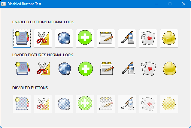

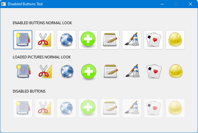

I was looking for a way to show the PNG images with an alpha channel on a Button control.
And I figured out how to do it.
The following image shows the result in MiniguiEx:
And how it is showed in HMG 3.4.4 with the same PRG source:
Your feedback is welcome 8-)

jorge_rivero wrote: Thu Mar 30, 2023 10:05 pm Envia el ejemplo
Gracias
Hello Jorge,
Thanks for your interest ;)
My hugs to Argentina from Ukraine.
The sample source code is below:

Please take a look at the following PNG image as an example: :arrow:
PNG image example
PNG image example

Hi To All ,
How to make Draw Transparent in Hmg? I didn´t get Transparent effect in HMG as it Gets in MINIGUI.
Thank´s in Advance

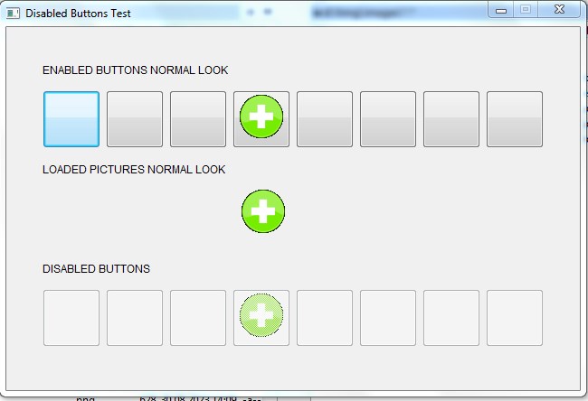

Hello everyone
I have 2 questions
1. half of my buttons are grayed out, what's causing it, I can remove it. There are nice white ones in the attachment from gfilatov.
2. is the way to implement the mentioned adjustment in HMG
Georg

Hi To All ,
As you can See in Hmg Version there is a little Black Border . In Minigui version it does not exist this black border

Re: Put PNG image with an alpha channel on a Button
Post by Georg_BA »
I'm talking about the gray half of the button
