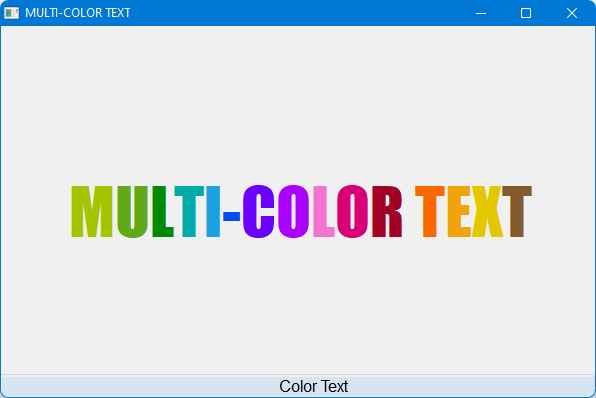

Hello guys,
There is a small issue with rendering multi-colored text on the form.
You can get this with a Label control for each letter, but that's very inconvenient.
I prepared a new example using the ON PAINT event to draw colorful text without using any labels.
Please see the result in the image below. :arrow:
Color Text
Color Text
Do you think this feature is useful :?:
Your feedback is welcome.

Rathinagiri wrote: Tue Jun 20, 2023 3:08 pm That is really nice!
Thanks for your feedback.
The main logic is below:
#include "i_winuser.ch"
FUNCTION Main
   LOCAL cText := "MULTI-COLOR TEXT"
   LOCAL hFont
   hFont := GetFontHandle( "Font_Text" )
   IF hFont == 0
      DEFINE FONT Font_Text FONTNAME "IMPACT" SIZE 48
   SET EVENTS FUNCTION TO App_OnEvents
   DEFINE WINDOW Form_Main ;
         AT 0, 0 ;
         WIDTH 600 HEIGHT 400 ;
         TITLE cText ;
         MAIN ;
         ON SIZE InvalidateRect( This.Handle, 0 ) ;
         ON MAXIMIZE InvalidateRect( This.Handle, 0 ) ;
         ON PAINT App_OnPaint( This.Handle, hFont, cText )
      DEFINE STATUSBAR FONT "Arial" SIZE 12
         STATUSITEM "Color Text" BACKCOLOR HMG_n2RGB( GetSysColor( COLOR_GRADIENTINACTIVECAPTION ) )
      END STATUSBAR
   CENTER WINDOW Form_Main
   ACTIVATE WINDOW Form_Main
#define DT_SINGLELINE 32
#define DT_CALCRECT  1024
FUNCTION App_OnPaint( hWnd, hFont, cText )
   LOCAL aColors := { ;
      METRO_LIME, METRO_GREEN, METRO_EMERALD, METRO_TEAL, METRO_CYAN, ;
      METRO_COBALT, METRO_INDIGO, METRO_VIOLET, METRO_PINK, METRO_MAGENTA, ;
      METRO_CRIMSON, METRO_RED, METRO_ORANGE, METRO_AMBER, METRO_YELLOW, ;
      METRO_BROWN, METRO_OLIVE, METRO_STEEL, METRO_MAUVE, METRO_TAUPE }
   LOCAL aRect := { 0, 0, 0, 0 }
   LOCAL c, n, hDC, nRight, bk
   GetClientRectArea( hWnd, aRect )
   // Center Statusbar Text
   Form_Main.Statusbar.Item( 1 ) := PadC( "Color Text", aRect[ 4 ] / 4 )
   hDC := GetDC( hWnd )
   // Center Text
   n := DrawTextEx( hDC, cText, aRect, DT_SINGLELINE + DT_CALCRECT, hFont, 0, @nRight )
   aRect[ 1 ] += ( aRect[ 3 ] - aRect[ 1 ] - n ) / 2
   aRect[ 2 ] += Int( ( aRect[ 4 ] - nRight ) / 2 )
   // Paint Text
   bk := SetBkMode( hDC, 1 )
   FOR n := 1 TO Len( cText )
      c := SubStr( cText, n, 1 )
      DrawTextEx( hDC, c, aRect, DT_SINGLELINE + DT_CALCRECT, hFont, aColors[ n ], @nRight )
      DrawTextEx( hDC, c, aRect, DT_SINGLELINE, hFont, aColors[ n ] )
      aRect[ 2 ] := nRight
   SetBkMode( hDC, bk )
   ReleaseDC( hWnd, hDC )
I've also attached a demo executable for your review. :arrow:
demo.zip
Demo executable
(913.99 KiB) Downloaded 258 times

serge_girard wrote: Wed Jun 21, 2023 6:12 am Grigory,
Also possible to resize on RESIZE?
Serge,
Yes, sure.
The text will be center-aligned to the height and width of the form's client area.
You can try the demo application above in your environment. ;)
Thanks for your interest.
