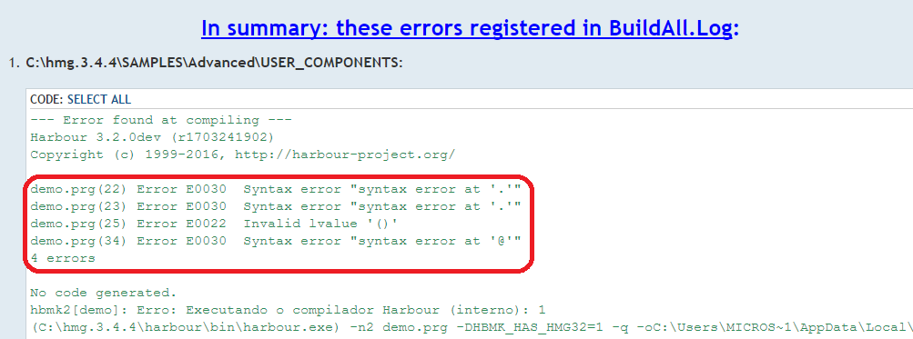

In summary: these errors registered in BuildAll.Log:
  1. C:\hmg.3.4.4\SAMPLES\Advanced\USER_COMPONENTS:
    --- Error found at compiling ---
    Harbour 3.2.0dev (r1703241902)
    Copyright (c) 1999-2016, http://harbour-project.org/
    demo.prg(22) Error E0030  Syntax error "syntax error at '.'"
    demo.prg(23) Error E0030  Syntax error "syntax error at '.'"
    demo.prg(25) Error E0022  Invalid lvalue '()'
    demo.prg(34) Error E0030  Syntax error "syntax error at '@'"
    4 errors
    No code generated.
    hbmk2[demo]: Erro: Executando o compilador Harbour (interno): 1
    (C:\hmg.3.4.4\harbour\bin\harbour.exe) -n2 demo.prg -DHBMK_HAS_HMG32=1 -q -oC:\Users\MICROS~1\AppData\Local\Temp\hbmk_gvicax.dir\ -iC:\hmg.3.4.4\harbour\include -i. -iC:\hmg.3.4.4\include
    HMG_IDE_NoRunApp

I checked the errors of c:\hmg.3.4.4\SAMPLES\Advanced\USER_COMPONENTS\
I found similar code in MiniGui Extended which was working fine. On comparing I found some difference and made some changes in HMG 3.4.4 to make it compile without any error.
Result is attached.
Please note that below lines are giving error in HMG but Ok in MiniGui,
MENUITEM 'Custom Method: Disable' ACTION Win1.Test.Disable
MENUITEM 'Custom Method: Enable' ACTION Win1.Test.Enable
MENUITEM 'Custom Property: Handle (Set)' ACTION Win1.Test.Handle := 1
Also I copied i_UsrInit.ch from MiniGui. The one in HMG include is zero bytes.
I will try sort out errors of HMG as as and when I get time. If Ok then I will request Rathi Sir, to add it in HMG for next release.
Please advise me if I make some mistake.

Anand
Re: Fixed and enhanced SAMPLES
Hi Anand,
Sorry to not agree with you right on your birthday. :|
But please take what I am going to say more for clarification purposes.
The decision to update USER_COMPONENTS is not up to me, but I need to clarify some facts:
A long time I am insisting to fix SAMPLES and many HMG versions were released already, most of then were corrected others with persistent errors.
I believe that Rathinagiri is forgetting to update or maybe I do not like my indications/corrections.
I do not know exactly because he likes silence intead to tell me the truth not to bother me... :lol: (Pls it's a joke)
But these messages since Jun, 2013 and on November, 2016: viewtopic.php?p=47854#p47854 I fixed (in both cases) and improved the USER_COMPONENTS. In this last, I wrote in ReadMe.txt:
- You will also need to check the "i_UsrSOOP.ch" file that is in the folder named <HMG_Root_Folder>\include
which should have the following content...
This indication serves to eliminate these errors in which I have recently referred and still persist:
Probably was Claudio or Rathinagiri but did not liked or at least did not mention any thing about if could be approved or not liked about this idea, these corrections. (silence again) :mrgreen:
Now I see your willingness to fix it, too. :)
This is good and healthy and all those have happened, stimulated even more to I do it better...
Unlike what I have proposed before (in my previous messages) for HMG in the file i_UsrSOOP.ch, I made instead the same changes in the file i_UsrInit.ch (current include file) thus only being useful for this demo and not affecting the rest in a permanent way.
Your said you found similar include from HMEE, but I disagree to use that, because there are particular functions that we do not use in HMG and also is not complete for last introduced demo.
In your demo, I've noted you have disable the lines where contains: HANDLE attrib, DISABLE and ENABLE at MENUITEMs because the compiling error.
Now I propose another version, free of error. Free of big changing in HMG and more options too... :P
USER_COMPONENTS.rar
Source files (2 Demos)
(5.23 KiB) Downloaded 305 times
USER_COMPONENTS_Exe.rar
Executables files (2 Demos)
(2.43 MiB) Downloaded 282 times
Please note that, in all my updating, I delete the previous versions for a reason of order and to preserve hosted space.. ..
Please Anand, do not take it personally.
I just wish everyone could collaborate as you did and we can achieve better examples in HMG SAMPLES.
Rathinagiri, I am still waiting for your response.

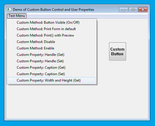

Please take in consideration the added second demo for LEFTJUSTIFY command at ChechBoxes (that's not demo included yet at HMG).
I will wait for your providences and your answer on my two requests Mr. Rathinagiri.

Demo1.exe gives error:
Date:04/07/17 Time: 17:19:12
Error BASE/1003 Variable does not exist: _SPLITCHILD_1_SETFOCUS
Called from GETCONTROLTYPE(1110)
Called from MYBUTTONSETFOCUS(128)
Called from DOMETHOD(8982)
Called from _HMG_PRINTER_MOUSEZOOM(7378)
Called from _HMG_PRINTER_SPLTCHLDMOUSECLICK(5362)
Called from EVENTPROCESS(161)
Called from DOMESSAGELOOP(0)
Called from _HMG_PRINTER_SHOWPREVIEW(5283)
Called from PRINTWINDOW(6382)
Called from (b)MAIN(27)
Called from EVENTS(1756)
Called from MAIN(48)
Thank you Serge for reporting.
I saw last night at Print Preview, doesn't it ?
Something around Events in this new control...
I still do not know what HMG wiil do if is gonna accept this demo or not...
Anyway I will see it in this afternoon.

It is strange and for me difficult to find a solution. :oops: (If nobody can help, better to cut off the preview option :| )
It's something about events with SplitChild... :?
"SETFOCUS" is coming as control name in MyButtonSetFocus.
So I tried to fix but it is a dirty and all buttons of preview loose its actions. Only Escape for exit.
Function MyButtonSetFocus ( cWindow , cControl )
Local i
i := Ascan ( _HMG_SYSDATA [ CTRL_NAME ] , cControl ) // I added this
If i > 0 // I added this
   If GetControlType ( cControl , cWindow ) == 'MYBUTTON'
      SetFocus ( GetControlHandle ( cControl , cWindow ) )
      _HMG_SYSDATA [USR_COMP_PROC_FLAG] := .T.
   Else
      _HMG_SYSDATA [USR_COMP_PROC_FLAG] := .F.
   Endif
Else
   _HMG_SYSDATA [USR_COMP_PROC_FLAG] := .F. // I added this
Endif
I lost all my day and nothing with ActiveX + JS... :|
