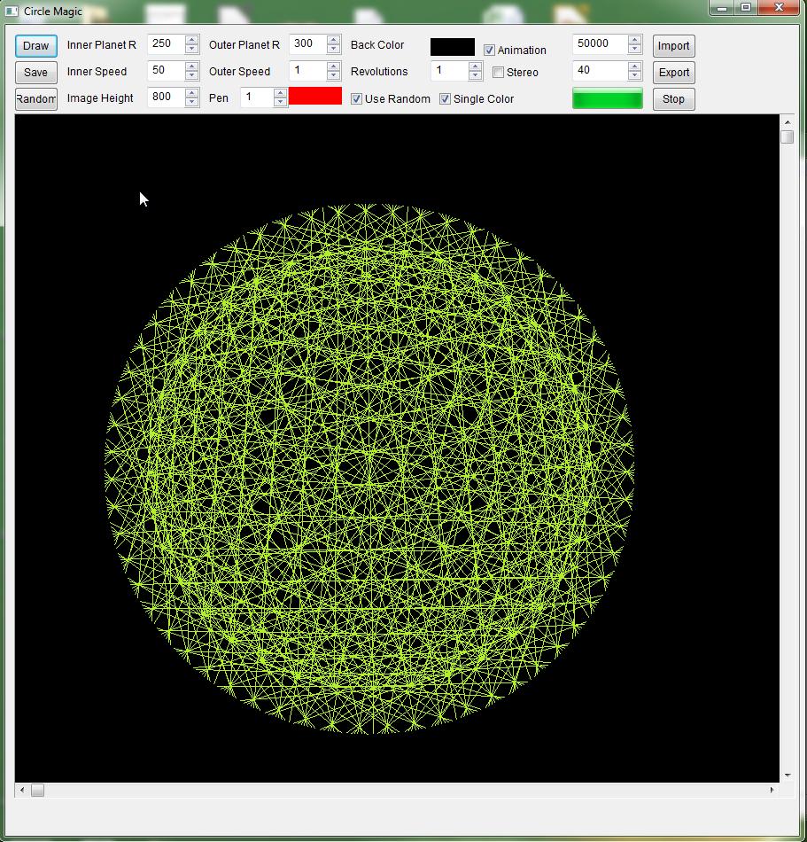

Circle Magic - New Version
Posts: 5481
This is to show case the power of HMG + BosTaurus.
This version of CircleMagic has the following features: ( All this in less than 700 lines of coding. I think it is not possible in any other language!)
- Double buffering as suggested by Claudio
- Animation ON/OFF
- Stereo 3D images ON/OFF & Flexible Distance
- Output Images of flexible size (up to 4000 x 4000 pixels) (made use of Panel window)
- Saving the image in bmp format
- Importing and exporting parameters in .ini files (To create again the same design)
- Random design creation
- Progress bar
- Stop intermediately
source code:
