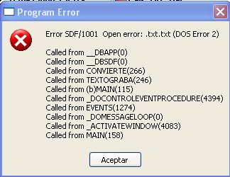

testing your code does not touch but showed an error and SDF
was created with a single empty file extension. TXT nameless,
I do not see this error again
Date:22/05/2009 Time: 18:10:37
Error SDF/1001 Open error: .txt.txt (DOS Error 2)
Called from __DBAPP(0)
Called from __DBSDF(0)
Called from CONVIERTE(266)
Called from TEXTOGRABA(246)
Called from (b)MAIN(115)
Called from _DOCONTROLEVENTPROCEDURE(4394)
Called from EVENTS(1274)
Called from _DOMESSAGELOOP(0)
Called from _ACTIVATEWINDOW(4083)
Called from MAIN(158)

Hola Esgici
creo que ya se lo que pasa con el error
si cargas un fichero para retocarlo y luego quieres guardarlo con su nombre u otro nombre pero cancelas la accion es cuando sale el error que te adjunto
Hello Esgici
I think it is what happens to the error
If you load a file you want to play and then save it with your name or other name but the action is canceled when you get the error attached

Hola Mustafa
Please try following :
Procedure TextoGraba
  Cfile:=putfile({{'txt','*.txt'},{'Configuracion','*.ini'}},"Grab\arArchivo")
  IF !EMPTY( Cfile )
     cContenido := Frm_1.Edit_1.value
     IF  "." $ Cfile
       CfileD := Cfile
       CfileD := Cfile+".txt"
     SetCurrentFolder( cPrgFolder )
     IF MEMOWRIT(CFileD,cContenido,.T.)
        msginfo("No se pudo grabar el archivo ","ATENCION !!!")
     Frm_1.Edit_1.value:="  "
     SAVE TO memuar ALL LIKE cFileD*
     Convierte()
  ENDIF !EMPTY( Cfile )

Hello Esgici
As always you have gone faster with the solution, ja .... ja ....
I found another solucioón you can serve.
IF "." $ Cfile
CfileD := Cfile
RESTORE FROM MEMUAR ADDITIVE
IF cFile <= space(1)+".txt"
msginfo("Acción Cancelada","ATENCION !!!")
SAVE TO memuar ALL LIKE SPACE(1)
ERASE .txt
Convierte()
Many greetings
