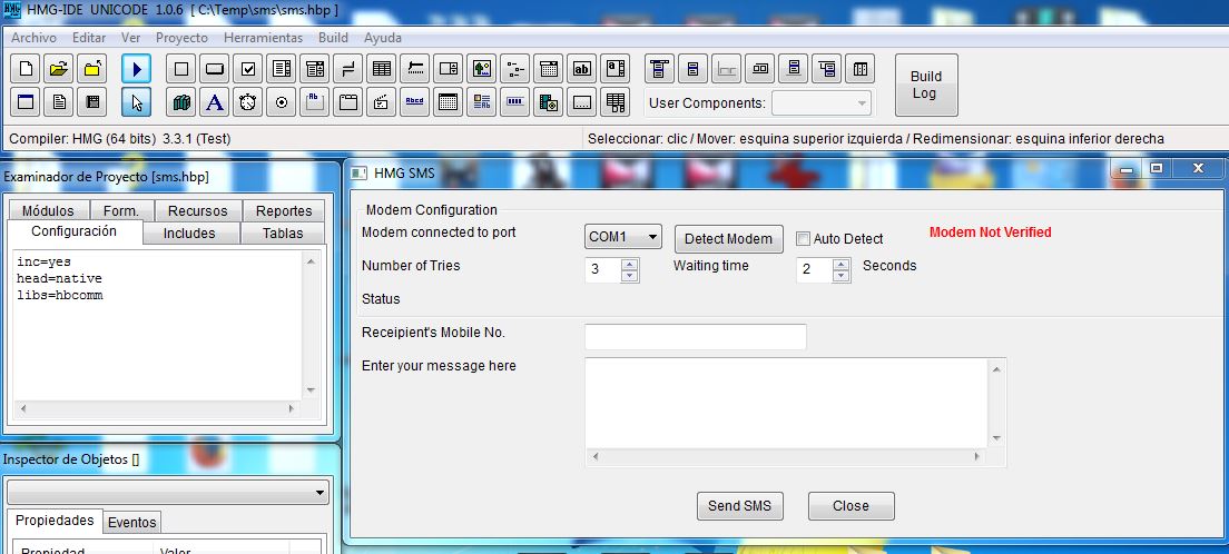

HI :
La aplicacion que hizo Roberto funciona correctamente en HMG.3.3.1 con IDE.1.0.6
Program Manager.jpg (99.34 KiB) Viewed 9294 times

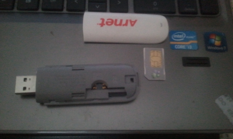

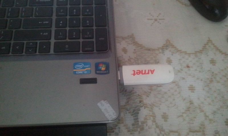

Modem Huawei E170
2014-09-23 08.29.42.jpg (157.84 KiB) Viewed 9294 times
2014-09-23 08.30.47.jpg (170.76 KiB) Viewed 9294 times

Copy library files to c:\hmg.3.3.1\lib and c:\hmg.3.3.1\lib64
sms.rar
(4.69 KiB) Downloaded 372 times

Re: Send SMS
Post by Agil Abdullah »
Thanks Daniel,
It works now.
