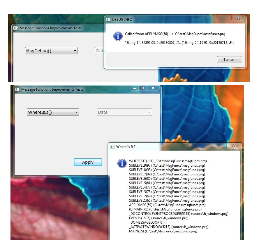

Now, we have a new ( and highly useful ) msg function MsgDebug() with an extra feature: this function accept "elastic" count of parameters :o
And another very handy debug function : ListCalledFunctions()
( WhereIsIt() has been replaced :( )
This little sample will try demonstrate these important ( at least for me ;) ) enhancement in HMG.

Screen shoots of MsgFuncs sample
