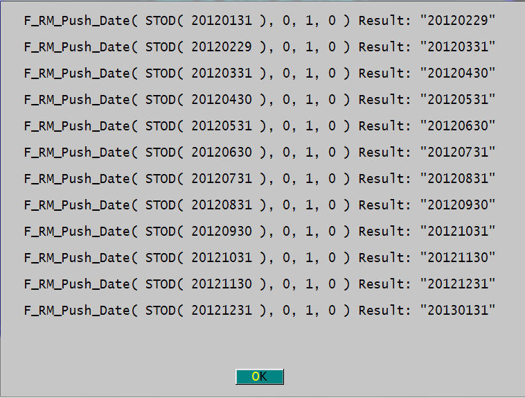

I Have Tryed with your sample: But my result is correct: Just one month added
DTOS( F_RM_Push_Date( STOD( '20120131' ), 0, 1, 0 ) )
RESULT := '20120229'
DTOS( F_RM_Push_Date( STOD( '20121231' ), 0, 1, 0 ) )
RESULT := '20130131'
I have maked some changes in the function to be safe from locale date settings ;)
May solve this error (new code edited in my last message : before this post)...
Best regards...

Tnx for your immediate response. Yeah! that output is right. I rechecked it again. It was my fault. How about this one.
F_Push_Date( CTOD('01/30/2012'), 0, 1, 0 ) => Result 03/01/2012 instead of 02/29/2012
F_Push_Date( CTOD('01/30/2012'), 0, 1, 0 ) => Result 03/02/2012 instead of 02/29/2012
Tnx a lot again.
Tested: and found no any problem...
F_RM_Push_Date( STOD( '20120130' ), 0, 1, 0 ) == STOD( '20120229' )
But I have a new release for function: Check if initial date have the Last Day of the month...
Function Updated Again...
Less code... better use...
Thank's for reporting possible error's
