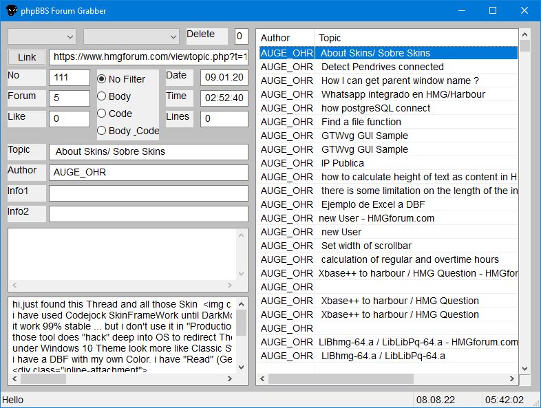

i have made Sample which show what i mean
i like to have Database to search "Local" e.g. when can not connect to Forum
- ForumHMG.jpg (124.36 KiB) Viewed 48296 times
it does collect Message from HMG Forum and can "extract CODE"
it also collect Message BODY to search for
"Problem" : both include HTML "Tag" ...
on Top i made 2 x ComboBox
1.) Forum Name (can be every phpBB System )
2.) Forum Category
but they are no "filled" in this Demo
also "Download" Source is not "activate"
but Button "Link" is working so you can goto Original
Radio Button ( not resize ? ) is to SET FILTER
SET FILTER TO !DELETED()
SET FILTER TO !EMPTY(FORUM->BODY) .AND. !DELETED()
SET FILTER TO !EMPTY(FORUM->CODE) .AND. !DELETED()
SET FILTER TO !EMPTY(FORUM->BODY) .AND. !EMPTY(FORUM->CODE) .AND. !DELETED()
Start Demo using
Default is HMGFORUM.DBF (will be create)
todo :
FILTER for Author and "Keyword"
MENU : "Download"
DBF with Forum Category
do you like Idea

Posted: Sun Aug 14, 2022 6:15 am
by AUGE_OHR
here 1st Release of "PhpBB Forum Grabber"
- phpBB_Forum_Grabber.JPG (209.79 KiB) Viewed 48128 times
Start App and press F7 to get 100 Thread
it will take about 50 Sec
look into Statusbar when finish before "big" Download ( > 1 Hour )
App will create
FORUMDIR.DBF
HTMLSIGN.DBF
FORUM.DBF
FORUM.fpt
FORUM.CDX
you can change FORUMDIR->LOCALPATH to your Folder
! Note : for Network use UNC-Path (no Drive Letter)
FORUM.DBF is to hold Message of a Forum (see FORUMDIR->LOCALPATH )
use separate Folder if you watch more PhpBB Forum***
HTMLSIGN.DBF include String with HTML-Code with can be used with
STRTRAN(FIELD-BODY,HTMLSIGN->HTMLSIGN,HTMLSIGN->CHANGETO)
See Menu
CTRL + F will open Window for"Keyword" and/of "Author"
"Keyword" in RTF will use Method "FindText" to show what found in BODY ( not in CODE (yet) )
it does work well with HMG Forum but with Xbase++ Forum many "Topic" are empty
BODY and CODE and all other Information of HTML File are OK, so you can work with it
Todo :
"Translate" BODY to other Language
