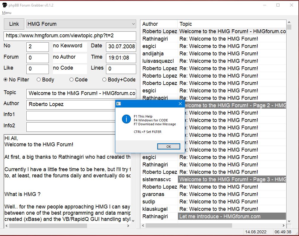

Re: HMG Forum "Codebox" Reader
hi Serge,
i have made Sample which show what i mean
i like to have Database to search "Local" e.g. when can not connect to Forum
it does collect Message from HMG Forum and can "extract CODE"
it also collect Message BODY to search for
FORUMHMG.ZIP
(1.76 MiB) Downloaded 786 times
"Problem" : both include HTML "Tag" ...
on Top i made 2 x ComboBox
1.) Forum Name (can be every phpBB System )
2.) Forum Category
but they are no "filled" in this Demo
also "Download" Source is not "activate"
but Button "Link" is working so you can goto Original
Radio Button ( not resize ? ) is to SET FILTER
 SET FILTER TO !DELETED()
 SET FILTER TO !EMPTY(FORUM->BODY) .AND. !DELETED()
 SET FILTER TO !EMPTY(FORUM->CODE) .AND. !DELETED()
 SET FILTER TO !EMPTY(FORUM->BODY) .AND. !EMPTY(FORUM->CODE) .AND. !DELETED()
Start Demo using
   FORUMHMG.exe JIMMY.DBF
Default is HMGFORUM.DBF (will be create)
here 1st Release of "PhpBB Forum Grabber"
FORUMHMG_18.zip
(1.55 MiB) Downloaded 663 times
Start App and press F7 to get 100 Thread
it will take about 50 Sec
look into Statusbar when finish before "big" Download ( > 1 Hour )
App will create
FORUMDIR.DBF
HTMLSIGN.DBF
FORUM.DBF
FORUM.fpt
FORUM.CDX
you can change FORUMDIR->LOCALPATH to your Folder
! Note : for Network use UNC-Path (no Drive Letter)
FORUM.DBF is to hold Message of a Forum (see FORUMDIR->LOCALPATH )
use separate Folder if you watch more PhpBB Forum***
HTMLSIGN.DBF include String with HTML-Code with can be used with
STRTRAN(FIELD-BODY,HTMLSIGN->HTMLSIGN,HTMLSIGN->CHANGETO)
See Menu
CTRL + F will open Window for"Keyword" and/of "Author"
"Keyword" in RTF will use Method "FindText" to show what found in BODY ( not in CODE (yet) )
it does work well with HMG Forum but with Xbase++ Forum many "Topic" are empty
BODY and CODE and all other Information of HTML File are OK, so you can work with it
