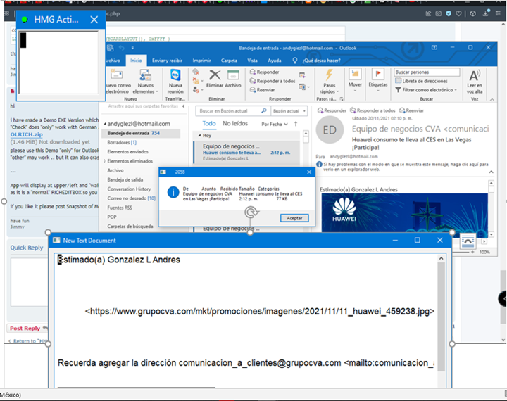

Re: "shell.explorer.2" and "Drop" from Outlook
Posted: Sat Nov 20, 2021 10:21 pm
by andyglezl
En español, parece OK
In Spanish, it seems OK
