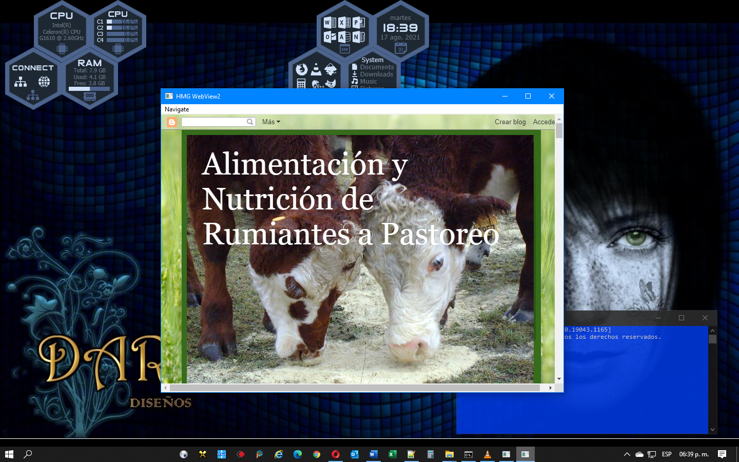

After much trial and error, and fight a little with the parameters of hbmk2 I managed to create a demo of HMG with Edge WebView2.
It is not much information on Edge WebView2 compiled with GCC/MinGW on the Internet maybe because most people use Visual Studio to build WebView2 applications. Most of the samples use MSVC ++ and a few of Microsoft's own compiler C++ classes.
I hope you enjoy!

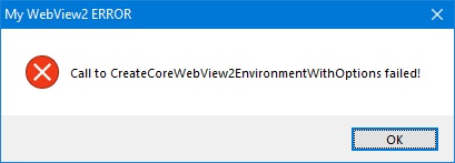

try to run Sample and got Error
Windows Version 10.0.19044.1165
Microsoft Edge Version 92.0.902.73 (Offizielles Build) (32-Bit)

AUGE_OHR wrote: Tue Aug 17, 2021 2:54 am hi,

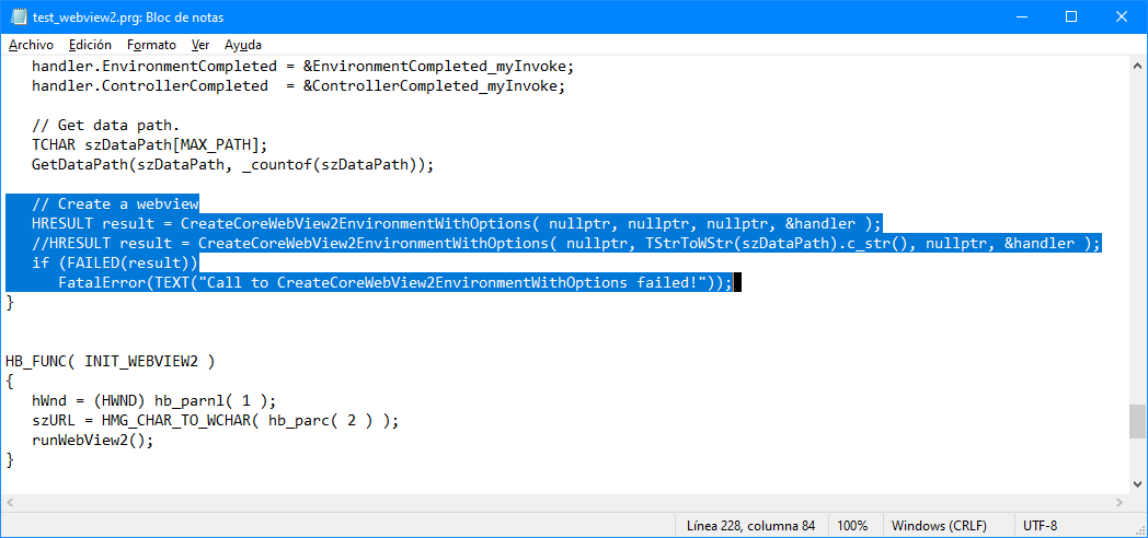

1) My .exe not work?
2) Try change this line in C code:
HRESULT result = CreateCoreWebView2EnvironmentWithOptions( nullptr, TStrToWStr(szDataPath).c_str(), nullptr, &handler );
For this line:
HRESULT result = CreateCoreWebView2EnvironmentWithOptions( nullptr, nullptr, nullptr, &handler );

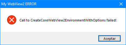

Posted: Tue Aug 17, 2021 5:11 am
by andyglezl
srvet_claudio wrote: Tue Aug 17, 2021 4:05 am Hi,
Así como viene el .exe que envió despliega lo siguiente.
For this line:
Resulta el mismo mensaje al volverlo a compilar ya modificado...

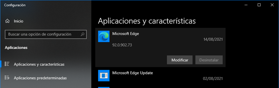

Posted: Tue Aug 17, 2021 10:42 pm
by srvet_claudio
Hi Andres,
The information on the internet is scarce, but the problem seems to be with the runtime version you have of webview2, please update your runtime version from this Microsoft link:
https://go.microsoft.com/fwlink/p/?LinkId=2124703
Re: HMG with Edge WebView2
Posted: Tue Aug 17, 2021 11:42 pm
by andyglezl
srvet_claudio wrote: Tue Aug 17, 2021 10:42 pm Hi Andres,
Solucionado Dr. Soto, muchas gracias por su ejemplo y ayuda !
