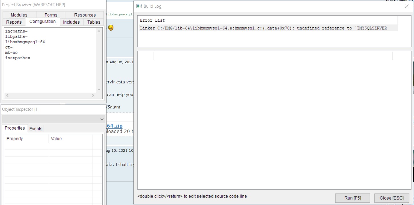

Hello Mustafa,
I am getting the same problem. Shall I need to change the configuration?
Screenshot 2021-08-10 111011.jpg (102.16 KiB) Viewed 25166 times
Thanks a lot :-)
