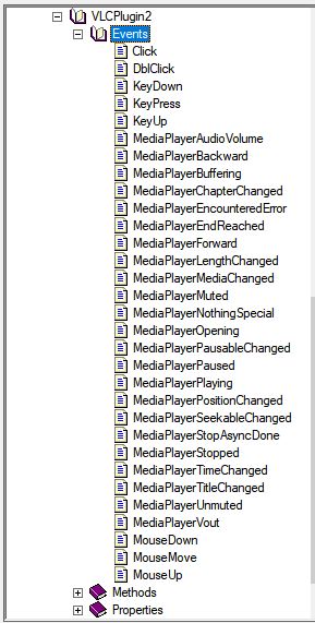

i got VLC running but like my WMP Player i can "only" Get/Set Property or call Method
EVENTMAP seems the missing Point to receive Notify Events from ActiveX Control
i have look into MiniGUI c:\MiniGUI\SOURCE\h_activex.prg, which is "big", and HMG
in c:\hmg.3.4.4\SOURCE\c_controlmisc.c there is HB_FUNC( INITACTIVEX ) but that all
i guess i can´t get Notify Event under HMG while it have nothing like EVENTMAP, or :?:
i have learn to get Windows Message ( WM_* ) Event under HMG but how about Notify Event from ActiveX :idea:

HMG Version does not support Notify Events so i can´t get Mouse or Keyboard Events "from" VLC ( e.g. Fullscreen - Mode )

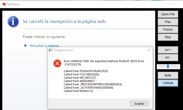

Hola Jimmy :
no existe myplayer.ico y da error

hm ... Error point to Line 282 and say Method does not exit
282       ::oPlaylist := oControl:playlist
it come from
   // create VLC object
127   oVlc := TVlc():New( Win1.Activex1.Object )
so i have to ask if VLC is installed :?:
VLC ActiveX Plugin and IE Web Plugin v2
{9BE31822-FDAD-461B-AD51-BE1D1C159921}
