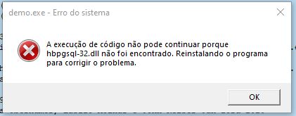

Thank you very much for your help. PGRDD.prg it´s already missing.
I´d put ít in the PostgrSql´s sample folder and recompile. And... more errors.
Also needded to add libhbpgsql.a and libhbpgsql_dll.a, recompile and.... more errors....
and after add...
It seems the endless story...
Did you try the HMG extended sample ? It compiles without any error but does not run because of libpq.dll (I don´t know wich is the right version).
I´ll try again in a few days.

Well, finally I got to compile without errors the demo program using all DLLs from Postgre Sql v8.
It compiled without errors, but does not open the main window, does not connect to database neither shows any error messages.
( I´ve tested the database engine and works properly ).
I think PostgreSql it´s not ready to use at this moment (at minimum level) and it´s not worth to continue spending time (mine), there are too many other flavors of SQL to choose.
Thank you for your help.

As I said, I got compile but exe crashes just after try to connect to server.
I used DLLs from version 8.3 and run Server version 9.4 (version 8.3 installs but does not run)
What DLLs version have you used to compile ? and what server version are you running?
I think I´ll do a new test in the next week with a brand new demo prg
best regards,
Salamandra, Brazil
