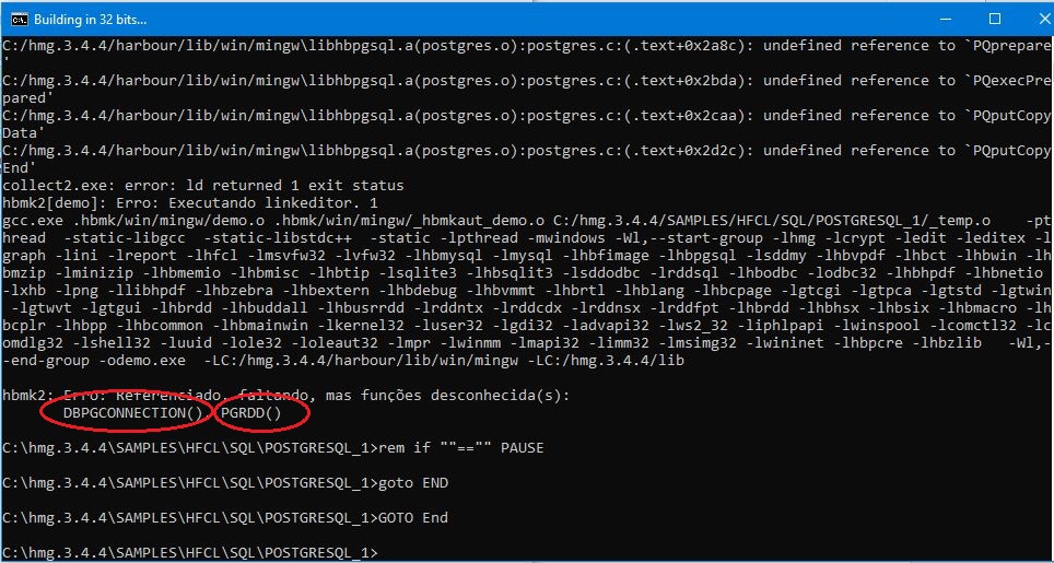

Hello everybody,
I would like to know if there is ( or anybody have ) a really working sample of PostgreSql.
I tried to compile the PosgrSql_1 sample from HMG 3.4.4. and got some errors that I Can´t solve because there are some functions that does not exists in Libhmg nor Libhmgpgsql.

Re: PostgreSql Libs not ready yet ?
as i can say HMG Sample is incomplet
here missing PgRDD.PRG
PGRDD.ZIP
(3.49 KiB) Downloaded 197 times
add PgRDD.PRG to demo.hbp
add : libs=hbpgsql.hbc
now when start it need LibPQ.DLL > v7.x and some other DLL here from v8.x

Thank you very much for your help. PGRDD.prg it´s already missing.
I´d put ít in the PostgrSql´s sample folder and recompile. And... more errors.
Also needded to add libhbpgsql.a and libhbpgsql_dll.a, recompile and.... more errors....
and after add...
It seems the endless story...

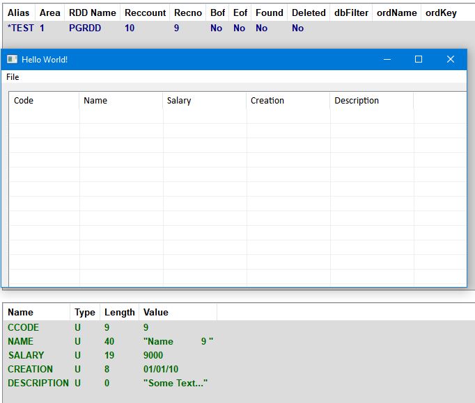

i "think" COLUMNCONTROLS() are not need but COLUMNFIELDS() are missing in Demo.PRG
COLUMNFIELDS { 'cCode' , 'Name' , 'Salary' , 'Creation' , 'Description' }
! Note : have rename "code" to "cCode"
now it got GRID ... but it is empty :o
when look in Debugger it have open Workarea
so what do i miss :idea:
please help
p.s. have also try BROWSE but same empty

edk
Posts: 999
Post by edk »
AUGE_OHR wrote: Thu Jul 16, 2020 1:49 am hi,
please help
Note the type of fields, they are all "U". This is probably the reason why the data is not shown in Grid and Browse.
have found PgRDD.PRG in old harbour Version. like SQLMIX it use USRRDD code.
but under harbour v3.x there is no Sample any more so i´m not sure if PgRDD.PRG is still valid :?:
have test this
  FOR EACH aFieldStruct IN aStruct
       aField := ARRAY( UR_FI_SIZE )
       aField[ UR_FI_NAME ]    := aFieldStruct[ DBS_NAME ]
       IF VALTYPE(aFieldStruct[ DBS_TYPE ]) = "U"
         aField[ UR_FI_TYPE ]  := "C"
         aField[ UR_FI_TYPE ]  := aFieldStruct[ DBS_TYPE ]
but aFieldStruct[ DBS_TYPE ] is valid
i guess "PGRDD" does not work as expect ...
how does USRRDD work ... any Information about it :idea:
