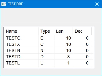

I had revised the above code and added the two new clauses:
AUTOSIZEHEIGHT <nRow> and AUTOSIZEWIDTH <.T.|.F.>
to a standard Grid control in MiniguiEx. 8-)
The updated program code and a result's screen are below: :arrow:

Re: calculate GRID height
Posted: Sat Feb 15, 2020 11:14 am
by AUGE_OHR
gfilatov wrote: Fri Feb 14, 2020 9:15 am I had revised the above code and added the two new clauses:
that looks fine, THX
