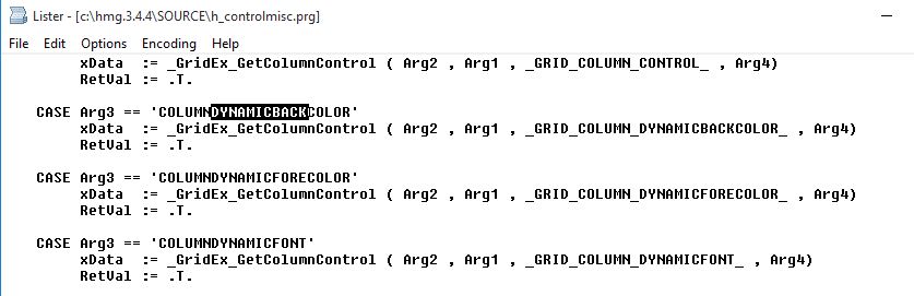

Hola Jimmy,
Pls share your Xbase++ App to me... tq
- hmg_dynamicback.JPG (49.14 KiB) Viewed 2811 times
it seem that the dynamic foreColor dan backColor functions are identical, wonder why it works with
foreColor but not backColor.
Thks n Rgds
Chang
