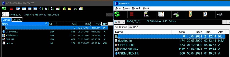

hmgchang wrote: Wed Apr 14, 2021 11:55 pm Pls share your Xbase++ App to me... tq
Xbase++ App (Black) need Runtime so tell me where i can upload hole Stuff
harbour App (white) Source (32/64 Bit) are on Github https://github.com/AugeOhr/HBFM
HMG have no Ownerdraw ( WM_MEASUREITEM / WM_DRAWITEM ) ...
it use Customdraw ( NM_CUSTOMDRAW ) for GRID / TREE
MiniGUI Extendet Version seems to have Ownerdraw for Menu and Listbox.
in GRID or TREE you can use "DynamicXXXcolor" while it use CustomDraw
