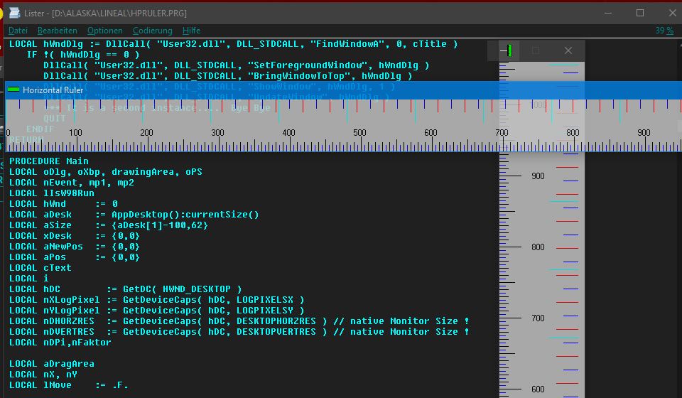

i'm searching for Ruler as App using harbour / HMG like this
do some one have made it an can share some Code :?:

bpd2000 wrote: Fri Jan 10, 2020 6:41 am Refer GridPlus,you will find Function DrawScale
have made simple "pure" HMG_Ruler
include Source and Icon as Resource.
please have a look at this Snapshot. Explorer does not show EXE Icon :?:
and why in Tasklist vertical Icon is not shown :?:
HMG_RULER.ZIP
(3.43 KiB) Downloaded 193 times
as the vertical is only 120 wide i can't use Titlebar to move it ... and it have a Artifact left of it.
how can i get ride of of Min/Max Button Space (!) under HMG :?:

Re: App as Ruler
Posted: Mon Jan 13, 2020 5:17 am
by AUGE_OHR
new Version :
5 Point mark
Context Menu for Transparency
NOMAXIMIZE NOMINIMIZE -> no Artefact
now vertical Ruler can be moved using Titlebar
here is the Source
HMG_RULER2.ZIP
(3.83 KiB) Downloaded 210 times
