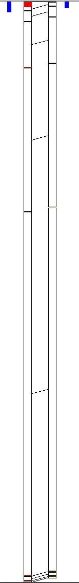

this is CLICK.PRG from Click_3.01_HMG.rar vs. Original Cl*pper Version compare with WinDiff as Grafic
this is my Xbase Code
i wonder why make so many Change while it are only FT_ Function which are not include in Source.
