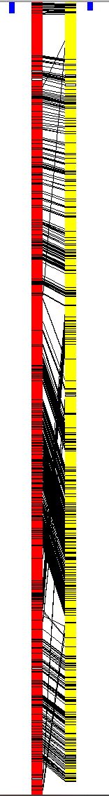

but the is a other Question with Click_3.01_HMG.rar : there are a lot of Code change :!:
this is CLICK.PRG from Click_3.01_HMG.rar vs. Original Cl*pper Version compare with WinDiff as Grafic
this is my Xbase Code
i wonder why make so many Change while it are only FT_ Function which are not include in Source.

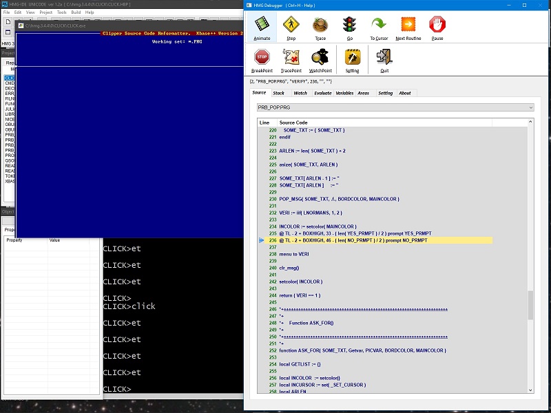

now i can compile/link and start App ... but it hang ... :evil:
INCOLOR := setcolor( MAINCOLOR )
@ TL - 2 + BOXHIGH, 33 - ( len( YES_PRMPT ) / 2 ) prompt YES_PRMPT
@ TL - 2 + BOXHIGH, 46 - ( len( NO_PRMPT ) / 2 ) prompt NO_PRMPT
menu to VERI
it is just a MENU TO but i "see" no PROMPT :?:
also no Variable in Debugger :shock: ... hm ...
