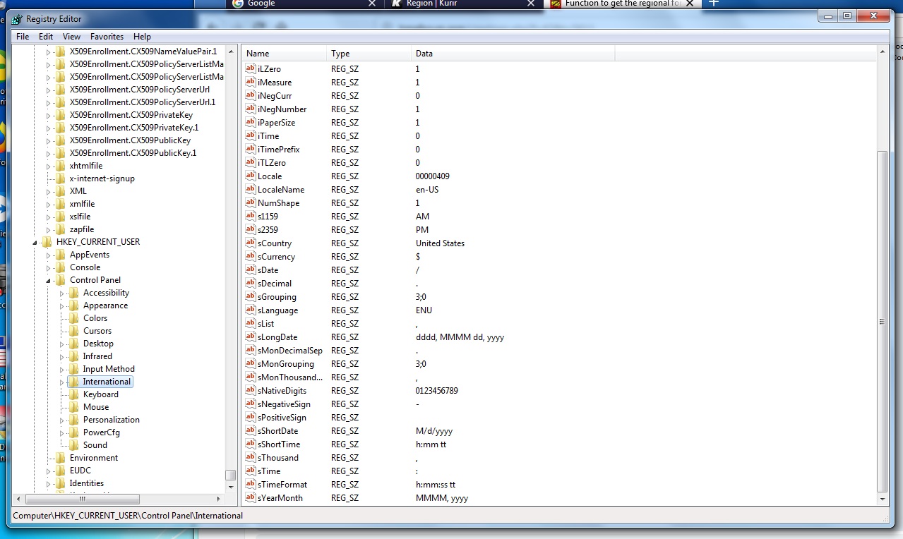

Windows Registry contain data what you need, just read

Suppose you want to know Country value from Registry, try working example
 * Copyright 2002-2008 Roberto Lopez <mail.box.hmg@gmail.com>
 * http://www.hmgforum.com//
 * bpd2000
PROCEDURE Main()
 ReadRegistryTest()
Return nil
Procedure ReadRegistryTest()
    private reg_key := 'HKEY_CURRENT_USER\Control Panel\International\sCountry'
  	reg_key_value := win_regRead ( reg_key)
    MsgInfo ( reg_key_value, 'Reg_key_value' )

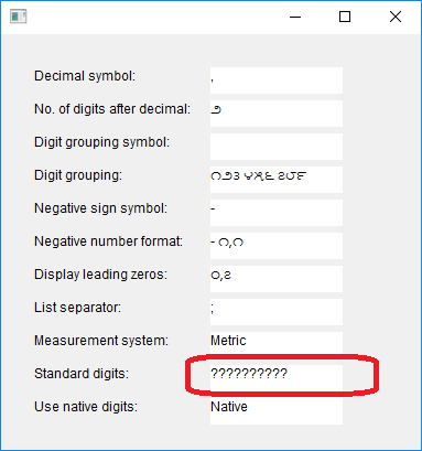

I do not know why I get invalid characters for LOCALE_SNATIVEDIGITS other than Arabic numbers?

edk wrote: Mon Apr 02, 2018 9:34 am I do not know why I get invalid characters for LOCALE_SNATIVEDIGITS other than Arabic numbers?
If you change LOCALE_SNATIVEDIGITS, try to change LOCALE_IDIGITSUBSTITUTION too.
Re: Function to get the regional format settings
Posted: Mon Apr 02, 2018 3:03 pm
by edk
KDJ wrote: Mon Apr 02, 2018 1:52 pm If you change LOCALE_SNATIVEDIGITS, try to change LOCALE_IDIGITSUBSTITUTION too.
So I did, but instead of these characters:
I get this in response:
I do not know if I compile correctly in UNICODE mode.

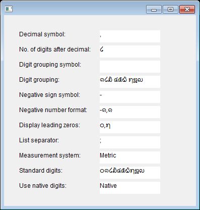

Posted: Mon Apr 02, 2018 4:02 pm
by KDJ
I have compiled it with HMG 3.4.4 32-bit, Win-7 64-bit, and all works properly:
