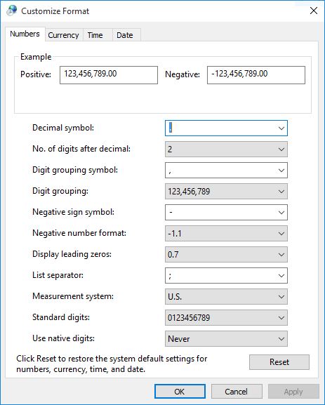

Dear All,
Is there any functions to get the regional format settings of the OS ?
Win10 regional format setting
regional format setting.JPG (52.61 KiB) Viewed 6700 times
TIA
best rgds
Chang

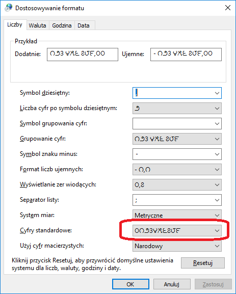

KDJ wrote: Mon Apr 02, 2018 1:52 pm If you change LOCALE_SNATIVEDIGITS, try to change LOCALE_IDIGITSUBSTITUTION too.
So I did, but instead of these characters:
I get this in response:
I do not know if I compile correctly in UNICODE mode.
KDJ
Posts: 243
Re: Function to get the regional format settings
Post by KDJ »
I have compiled it with HMG 3.4.4 32-bit, Win-7 64-bit, and all works properly:
edk
Posts: 999
Post by edk »
Well now I have a riddle :? .
I recompiled on a different machine (Win10-32bit) and the characters are displayed correctly :shock: .
On this computer, where characters are incorrectly displayed, the system Win10-64bit is brand new and the original unmodified hmg3.4.4 installed.
