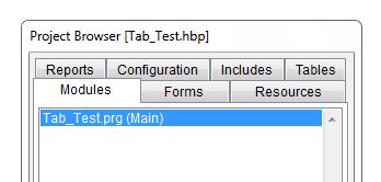

Hi All
May be a way to cascade tab control's pages button ?
Like HMG IDE Project Browser window:
HMG IDE Project Browser Form.JPG (19.19 KiB) Viewed 7311 times
    Cascading tab pages attempt

		DEFINE TAB tabTest ;
			AT 10,10 ;
			WIDTH 280 ;
			HEIGHT 400 ;
			MULTILINE

Try to define your TAB as below :arrow:
			AT 10,10 ;
			WIDTH frmTabsTest.WIDTH - 30 ;
			HEIGHT frmTabsTest.HEIGHT - 50;
			MULTILINE
8-)
Re: Cascading tab pages
Posted: Fri Mar 16, 2018 1:44 pm
by dragancesu
By the way, Dragan, Edward and Serge; did you tried ?
Look TAB WIDTH parameter (600), your is bigger then window width (300)
Posted: Sat Mar 17, 2018 1:09 am
Thanks to all helper: Edward, Dragan, Grigory and Serge :arrow:
It's time to retire for me :oops: :oops: :oops:
TAB Cascading (MULTILINE) sample.JPG (23.53 KiB) Viewed 7160 times
    Cascading tab pages ( MULTILINE) sample
    Thanks to HMG forum friends : Edward, Dragan, Grigory and Serge
	20180317
