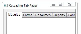

    Cascading tab pages attempt
PROC Main()
	DEFINE WINDOW frmTabsTest ;
		WIDTH 300 HEIGHT 300 ;
		TITLE 'Cascading Tab Pages' ;
		MAIN
		DEFINE TAB tabTest ;
			AT 10,10 ;
			WIDTH 600 ;
			HEIGHT 400;
			MULTILINE
			PAGE 'Modules'
			END PAGE
			PAGE 'Forms'
			END PAGE
			PAGE 'Resources'
			END PAGE
			PAGE 'Reports'
			END PAGE
			PAGE 'Configuration'
			END PAGE
			PAGE 'Includes'
			END PAGE
			PAGE 'Tables'
			END PAGE
		END TAB
    frmTabsTest.Center()
    frmTabsTest.Activate()
RETU // Main()
By the way, Dragan, Edward and Serge; did you tried ?
Windows 7 Ult; HMG 3.4.4
TIA

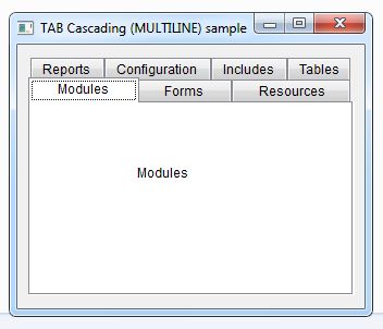

TAB Cascading (MULTILINE) sample.JPG (23.53 KiB) Viewed 7149 times
    Cascading tab pages ( MULTILINE) sample
    Thanks to HMG forum friends : Edward, Dragan, Grigory and Serge
	20180317
	http://www.hmgforum.com/viewtopic.php?f=14&t=5586
PROC Main()
		WIDTH 335 HEIGHT 280 ;
		TITLE 'TAB Cascading (MULTILINE) sample' ;
		MAIN
			AT 10,10 ;
			WIDTH 300 ;
			HEIGHT 220;
			MULTILINE
			PAGE 'Modules'
			   @ 100, 100 LABEL lblModules VALUE "Modules"
			END PAGE
			PAGE 'Forms'
			   @ 100, 100 LABEL lblForms VALUE "Forms"
			END PAGE
			PAGE 'Resources'
			   @ 100, 100 LABEL lblResources VALUE "Resources"
			END PAGE
			PAGE 'Reports'
			   @ 100, 100 LABEL lblReports VALUE "Reports"
			END PAGE
			   @ 100, 100 LABEL lblConfiguration VALUE "Configuration"
			END PAGE
			PAGE 'Includes'
			   @ 100, 100 LABEL lblIncludes VALUE "Includes"
			END PAGE
			PAGE 'Tables'
			   @ 100, 100 LABEL lblTables VALUE "Tables"
			END PAGE
		END TAB
RETU // Main()
