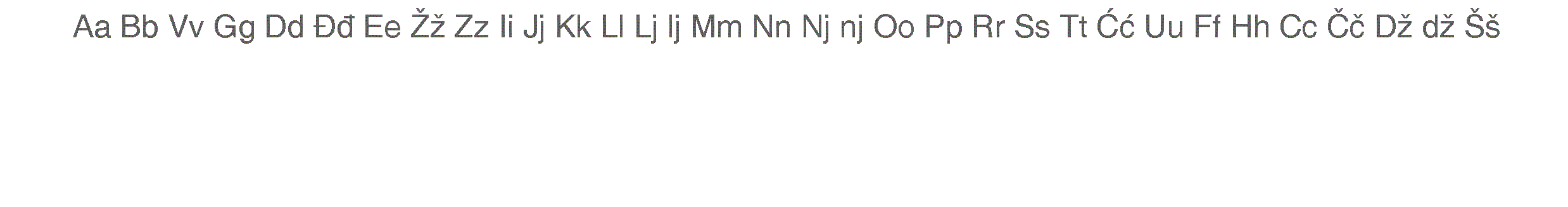

again i have a problem. I am using unicode version of HMG and when i use HPDFPRINT UNICODE statement, printout is not sharp. I enclose a sample.
What am I doing wrong?

In fact, the UNICODE text in HPDF is a graphic.
See function _HMG_HPDF_MULTILINE_PRINT_UNICODE() in the source "h_HMG_HPDF_UNICODE.PRG"

Maybe by better DPI of bitmap with Unicode text :?:
Can't You convert yours strings from Unicode to Ansi windows-1250 for hpdf?

This looks good to you, I did not manage to make a display of letters with the accents of ŠĐŽĆČ, so I gave up
but creating a print and using some print-to-pdf program works great

I checked the PDF in Serbian and in fact there is a problem with ANSI in this language. But what I noticed, Serbian has a similar alphabet to Slovenian and using Slovenian coding I managed to correctly create a PDF with the Serbian alphabet.

I can convert my application to WIN-1250 CODEPAGE and then i can use HPDFPRINT without UNICODE. But that means also correcting all strings in the code (like msginfo) and also all the data. I think this is the only solution since all dosc states that haru pdf is fixed to 72 dots per inch.
