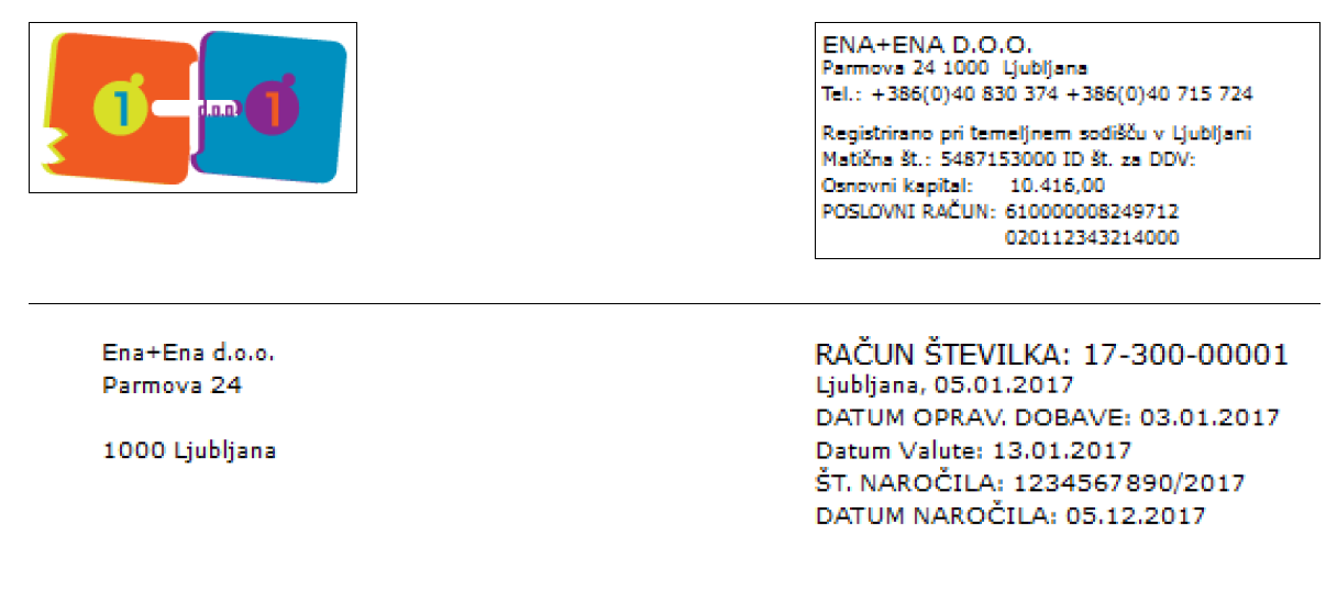

again i have a problem. I am using unicode version of HMG and when i use HPDFPRINT UNICODE statement, printout is not sharp. I enclose a sample.
What am I doing wrong?

Hi Drago,
Nothing wrong, just look at: http://www.hmgforum.com/viewtopic.php?f=24&t=5393

In fact, the UNICODE text in HPDF is a graphic.

Thank you very much fot your help edk. As I understand there is no solution print output is as it is.

Maybe by better DPI of bitmap with Unicode text
Can't You convert yours strings from Unicode to Ansi windows-1250 for hpdf?

Many complex language scripts can't be converted to ANSI.

This looks good to you, I did not manage to make a display of letters with the accents of ŠĐŽĆČ, so I gave up

You're right, but Drago probably creates a PDF in Slovenian. Can easily use ANSI encoding.Rathinagiri wrote: ↑Fri Dec 08, 2017 4:17 am Many complex language scripts can't be converted to ANSI.
I checked the PDF in Serbian and in fact there is a problem with ANSI in this language. But what I noticed, Serbian has a similar alphabet to Slovenian and using Slovenian coding I managed to correctly create a PDF with the Serbian alphabet.dragancesu wrote: ↑Fri Dec 08, 2017 7:24 am This looks good to you, I did not manage to make a display of letters with the accents of ŠĐŽĆČ, so I gave up

I can convert my application to WIN-1250 CODEPAGE and then i can use HPDFPRINT without UNICODE. But that means also correcting all strings in the code (like msginfo) and also all the data. I think this is the only solution since all dosc states that haru pdf is fixed to 72 dots per inch.
