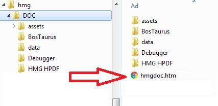

HMG has many documentation:
1- HMGDOC: come with HMG installation package:
2- You can reach it via HMG IDE:
HMG-IDE Banner.JPG (41.03 KiB) Viewed 7302 times
