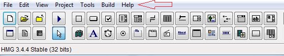

HMG has many documentation:
1- HMGDOC: come with HMG installation package:
2- You can reach it via HMG IDE:
HMG-IDE Banner.JPG (41.03 KiB) Viewed 7297 times

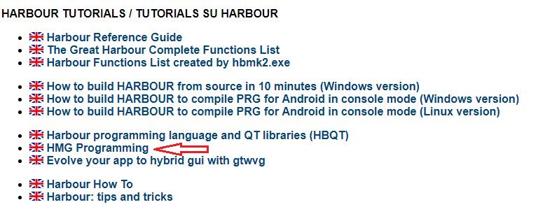

3- Giovanni's tutorials:
http://www.elektrosoft.it/tutorials.asp

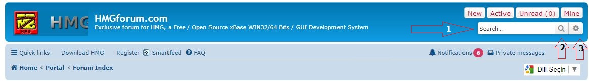

4- And finally this forum. You can ask everything you imagine on HMG. Use "search" box and its buttons:
HMG Forum Banner.JPG (59.5 KiB) Viewed 7297 times
Most probably a member may asked your question before you ;)
