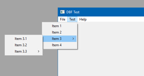

I have one question: how is possible to set drop side for main menu?
Now menu drop to left. I wish drop do the right.
On picture is actual situation.
Thanks in advance

Re: Main Menu Setting
Posted: Thu Jun 22, 2017 9:36 pm
by bobgen
That's right. If the window is set to the full screen or if the left edge of the window is on the left edge of the screen, then everything is fine.
However, this is not the case for standard windows apps.

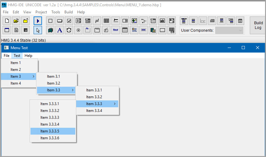

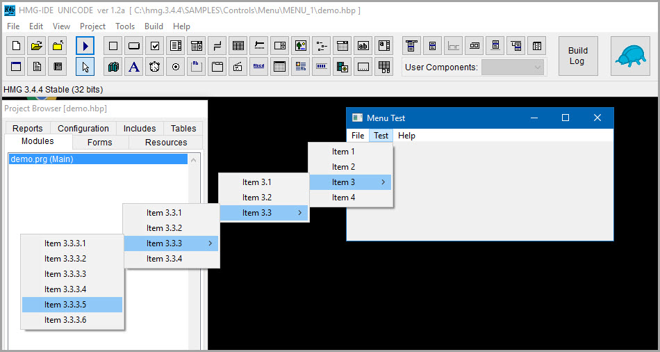

Below is the sample screen from c:\hmg.3.4.3\SAMPLES\Controls\Menu\MENU_1\
This was showing left-side drop menu earlier. But today it is showing correct i.e. right-side drop menu. Also my other application developed in Xbase++ are showing right-side drop menu.
My current Win10 version is as below,
I can only confirm that the same code is used and same exe is showing different than earlier, i.e. now in correct way.
Anand

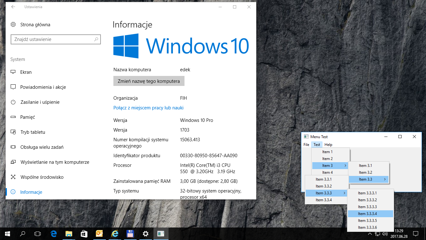

Something strange. My installation and demo:
Figure 1 is a win 10 setting.
a 2017-06-28_12-48-30.jpg (32.68 KiB) Viewed 7586 times
Figure 2 menu_1 from the Sample Folder.
b 2017-06-28_12-52-07.jpg (110.87 KiB) Viewed 7586 times

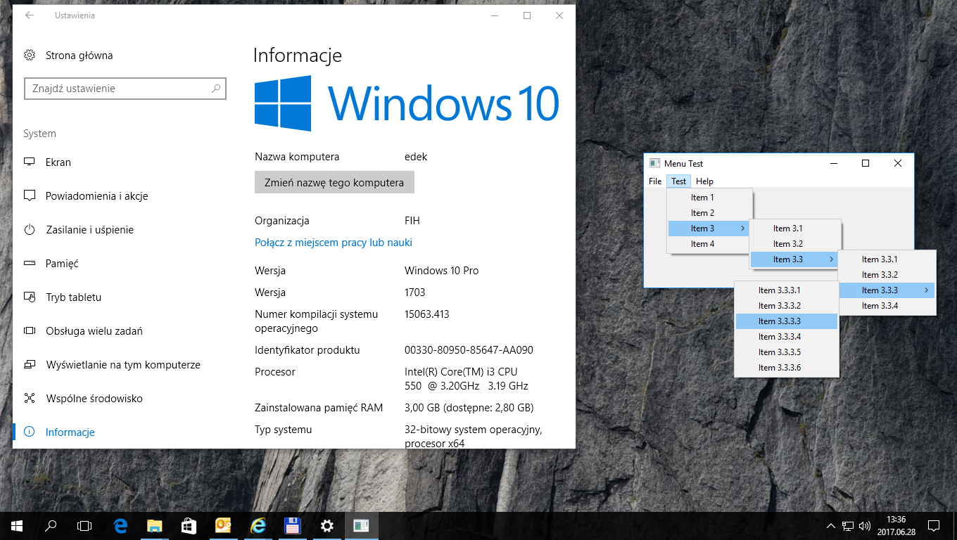

Figure 3 when I move the application window to the left edge.
c 2017-06-28_12-55-57.jpg (92.46 KiB) Viewed 7586 times

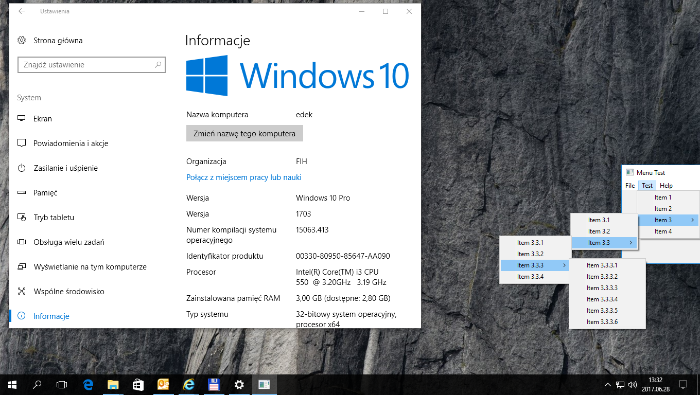

Posted: Wed Jun 28, 2017 11:50 am
by edk
I have the same OS build as bobgen and on my computer the popup menu is displayed correctly.
If there is not enough space to display the next popup menu on the right side, it is displayed on the left side.
