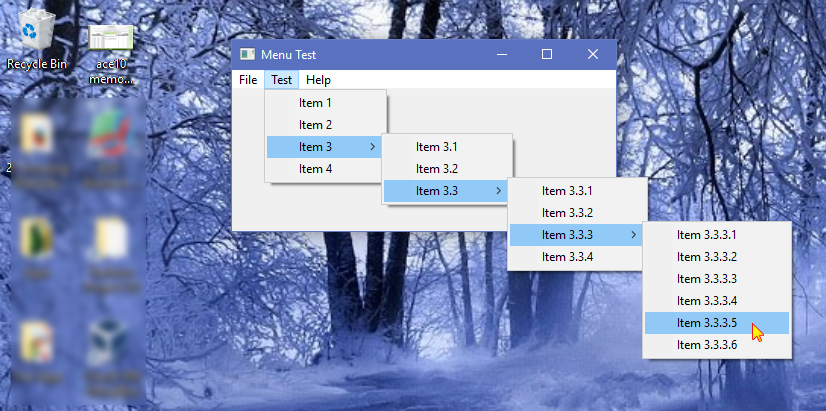

Below is the sample screen from c:\hmg.3.4.3\SAMPLES\Controls\Menu\MENU_1\
This was showing left-side drop menu earlier. But today it is showing correct i.e. right-side drop menu. Also my other application developed in Xbase++ are showing right-side drop menu.

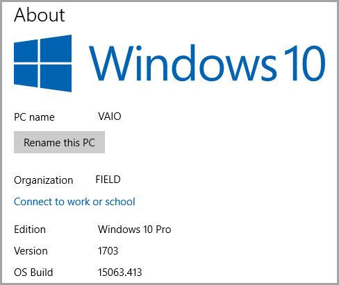

My current Win10 version is as below,
I can only confirm that the same code is used and same exe is showing different than earlier, i.e. now in correct way.

Something strange. My installation and demo:
Figure 1 is a win 10 setting.
a 2017-06-28_12-48-30.jpg (32.68 KiB) Viewed 7581 times
Figure 2 menu_1 from the Sample Folder.
b 2017-06-28_12-52-07.jpg (110.87 KiB) Viewed 7581 times
Figure 3 when I move the application window to the left edge.
c 2017-06-28_12-55-57.jpg (92.46 KiB) Viewed 7581 times

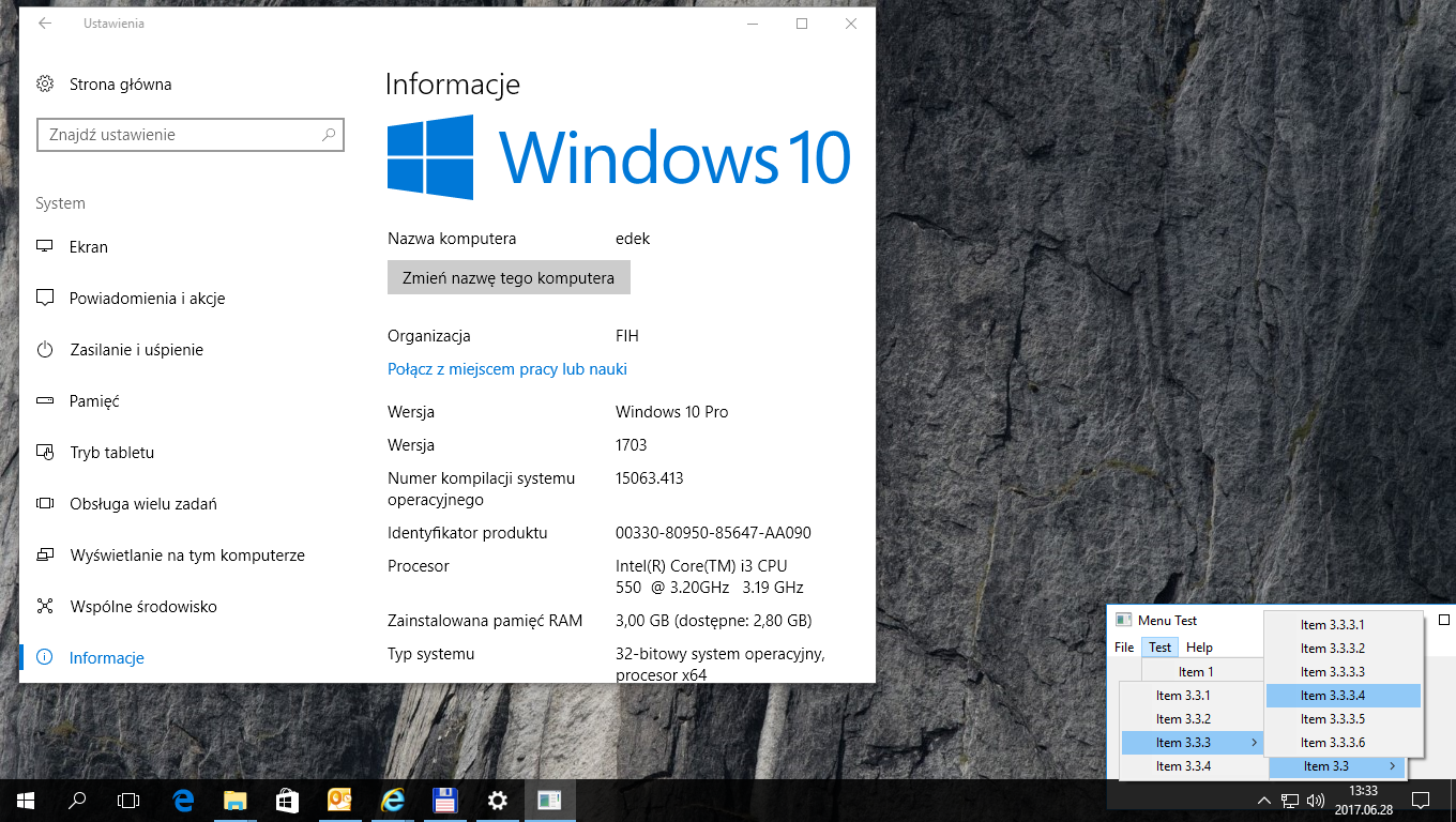

edk
Posts: 999
Re: Main Menu Setting
Post by edk »
I have the same OS build as bobgen and on my computer the popup menu is displayed correctly.
If there is not enough space to display the next popup menu on the right side, it is displayed on the left side.
