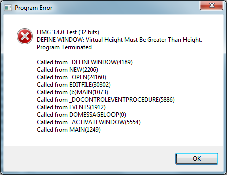

This is to inform you that this error is occurring when trying to open Form2.
What is the difference of these two forms:
DEFINE WINDOW TEMPLATE AT 345, 485 WIDTH 550 HEIGHT 350 VIRTUAL WIDTH Nil VIRTUAL HEIGHT Nil TITLE "Demo" ICON NIL
DEFINE WINDOW TEMPLATE AT 345, 485 WIDTH 550 HEIGHT 350 VIRTUAL WIDTH NIL VIRTUAL HEIGHT NIL TITLE "Demo" ICON NIL
Only Nil is acepted not NIL.
This behaviour is it normal :?:
Please load Main project at your IDE and try to open Form2:
IDE_Error.rar
Main project
(674 Bytes) Downloaded 317 times
This error causes the collapse of running of the IDE :o
