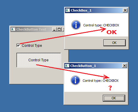

Recently I found there was not any demo for CHECKBUTTON at SAMPLES. This is not terrible but following bug occurrs for a very long time... (probably before 3.0.35) :shock: :
Function Main()
DEFINE WINDOW Form_1 ;
   WIDTH 200 ;
   HEIGHT 200 ;
   MAIN;
   TITLE 'CheckButton Test'
   @ 20,20 CHECKBOX CheckBox_1 CAPTION "Control Type" WIDTH 150 HEIGHT 50 ;
           ON CHANGE MsgInfo("Control type: "+GetControlType("CheckBox_1","Form_1"),(This.Name))
   @ 70,20 CHECKBUTTON CheckButton_1 CAPTION "Control Type" WIDTH 150 HEIGHT 50 ;
           ON CHANGE MsgInfo("Control type: "+GetControlType("CheckButton_1","Form_1"),(This.Name))
CENTER WINDOW Form_1
ACTIVATE WINDOW Form_1
In this demo the result should be CHECKBUTTON not CHECKBOX, right ?

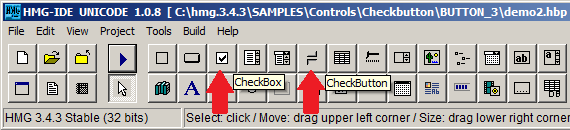

At least in HMG/IDE we have these names for control types. Or am I wrong about it ?

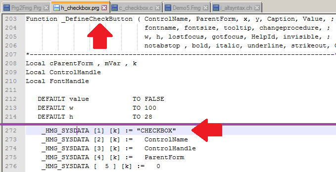

I've checked at C:\hmg.3.4.3\SOURCE\h_checkbox.prg and _DefineCheckButton function is declared IMO wrongly as "CHECKBOX" :o

Images and codes proves that is wrong control type for CheckButtons (for long time... :o )
MsgInfo("Control type: "+GetControlType("CheckButton_1","Form_1"),(This.Name)) => "CHECKBOX" :?:

CheckBox and CheckButton are both defined on "h_checkbox.prg", because they are (basically) the same control (exactly the same behavior) with different styles.
The following was a deliberate design decision:
_HMG_SYSDATA [1] [k] := "CHECKBOX"
The most important thing:
GetControlType() IS AN INTERNAL FUNCTION, NOT AIMED TO BE EXPOSED TO THE FINAL USERS, THIS IS THE REASON BECAUSE I'VE NOT INCLUDED IN THE DOCUMENTATION.
Advanced users, digging in HMG internals, will find their way to (if required) differentiate both controls.
Please, don't fix something that is not broken :)
