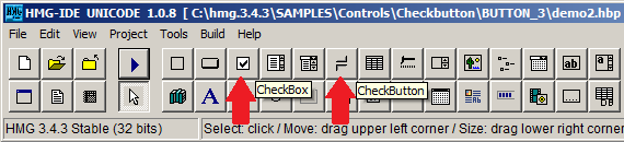

At least in HMG/IDE we have these names for control types. Or am I wrong about it ?

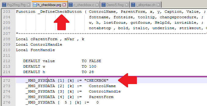

I've checked at C:\hmg.3.4.3\SOURCE\h_checkbox.prg and _DefineCheckButton function is declared IMO wrongly as "CHECKBOX" :o

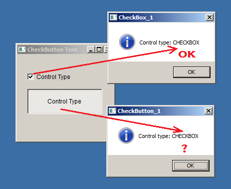

Images and codes proves that is wrong control type for CheckButtons (for long time... :o )
MsgInfo("Control type: "+GetControlType("CheckButton_1","Form_1"),(This.Name)) => "CHECKBOX" :?:

CheckBox and CheckButton are both defined on "h_checkbox.prg", because they are (basically) the same control (exactly the same behavior) with different styles.
The following was a deliberate design decision:
_HMG_SYSDATA [1] [k] := "CHECKBOX"
The most important thing:
GetControlType() IS AN INTERNAL FUNCTION, NOT AIMED TO BE EXPOSED TO THE FINAL USERS, THIS IS THE REASON BECAUSE I'VE NOT INCLUDED IN THE DOCUMENTATION.
Advanced users, digging in HMG internals, will find their way to (if required) differentiate both controls.
Please, don't fix something that is not broken :)

Sorry to disagree. :oops: Is not broken but wrongly working... :?
You said not exposed before because there was a fail?
Its means that we should not use GetControlType() ?
Because we can not trust in GetControlType().
So, what about GetProperty() ? We should not use neither ?
