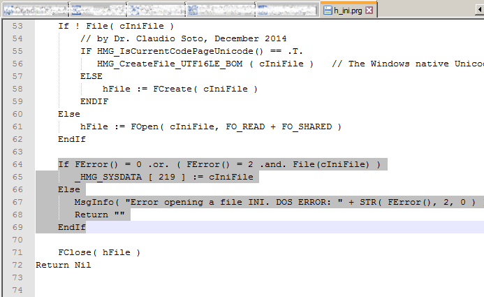

I have tested simple INI creation at Win7 and Win10.
In C:\hmg.3.4.3\SOURCE\Ini\h_ini.prg after HMG_CreateFile_UTF16LE_BOM returning a false error status.
Then I adjusted as follows:
This solved but is strange because error 2 (File not found) is returning but with File() it is existing file. :shock:

If ini file does not exist it is created by HMG_CreateFile_UTF16LE_BOM function and FError() is not updated.
And it seems to me, hFile variable should be initialized by -1, not 0.
