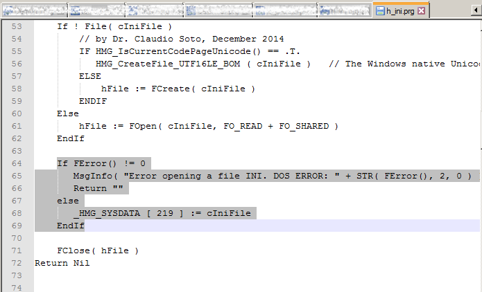

Hola Claudio,
I have tested simple INI creation at Win7 and Win10.
In C:\hmg.3.4.3\SOURCE\Ini\h_ini.prg after HMG_CreateFile_UTF16LE_BOM returning a false error status.
Then I adjusted as follows:
This solved but is strange because error 2 (File not found) is returning but with File() it is existing file. :shock:

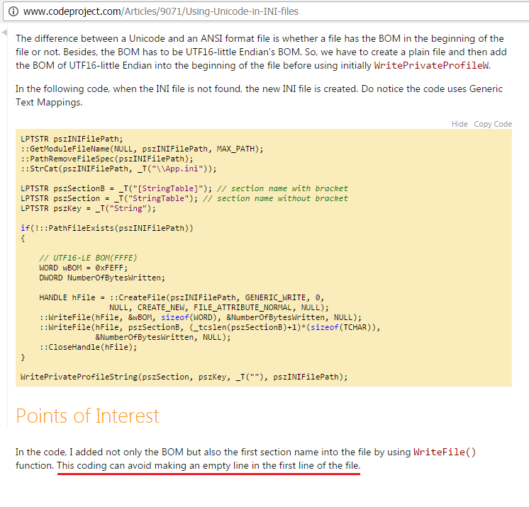

I remember I claimed a time ago for HMG_CreateFile_UTF16LE_BOM is creating with an empty line in the first line of the file and I saw this:
Also it mentions:
Why is it only UTF16-little Endian?
In Notepad included with Windows, we can choose 3 encoding formats in Unicode. These are "Unicode" (UTF16-little Endian), "Unicode big Endian" (UTF16-big Endian), and "UTF-8". We can use only UTF16-little endian of these formats as an INI file format. The other encodings do not work correctly (you examine it once). Probably, the reason is that Windows NT, XP or later uses the encoding internally. This is why Windows particularly names UTF16-little Endian "Unicode".
So, It could it affects reading INI files the Unicode format ?

Claudio, could you confirm us what would be the ideal UNICODE standard for INI files?
[tr][td]Bytes[/td][td]    [/td][td]Encoding Form[/td][/tr]
[tr][td]00 00 FE FF[/td][td]    [/td][td]UTF-32, big-endian[/td][/tr]
[tr][td]FF FE 00 00[/td][td]    [/td][td]UTF-32, little-endian[/td][/tr]
[tr][td]FE FF[/td][td]    [/td][td]UTF-16, big-endian[/td][/tr]
[tr][td]FF FE[/td][td]    [/td][td]UTF-16, little-endian[/td][/tr]
[tr][td]EF BB BF[/td][td]    [/td][td]UTF-8[/td][/tr][/table]
Because I'm working on with this:
FWrite( hFile, Chr(0xEF)+Chr(0xBB)+Chr(0xBF) )
// UTF-8-BOM
Instead of: HMG_CreateFile_UTF16LE_BOM ( cIniFile ) because this C function making an empty line in the first line of the INI files. :?
Also which UNICODE standard for FMG files ?
Waiting for you directive.
Thank you in advanced.
I am taking the opportunity to make this article available:
http://unicode.org/faq/utf_bom.html
Re: False FError return at INI file creation
Windows work with UTF16LE
16 is compatible with old, 32 and 64... and same for FMG files when be UNICODE, of course.
Thank you.
Pablo César wrote:Instead of: HMG_CreateFile_UTF16LE_BOM ( cIniFile ) because this C function making an empty line in the first line of the INI files. :?
Sorry, my deduction: totally wrong ! :|
You already told me that you could not skip this line. :oops:
And now I know it's because of the WritePrivateProfileString / API function and its 0xFF and 0xFE for UTF16LE_BOM at first as head of INI file.
Let's keep HMG_CREATEFILE_UTF16LE_BOM.
Sorry I was a hardheaded. :mrgreen:

If ini file does not exist it is created by HMG_CreateFile_UTF16LE_BOM function and FError() is not updated.
And it seems to me, hFile variable should be initialized by -1, not 0.
FUNCTION BeginIni(name, cIniFile )
    LOCAL hFile := 0
    * Unused Parameter
    if HB_UAT("\",cIniFile)==0
       cIniFile := ".\"+cIniFile
    If ! File( cIniFile )
        // by Dr. Claudio Soto, December 2014
        IF HMG_IsCurrentCodePageUnicode() == .T.
           HMG_CreateFile_UTF16LE_BOM ( cIniFile )   // The Windows native Unicode character set is in UTF-16LE
            hFile := FCreate( cIniFile )
    Else
        hFile := FOpen( cIniFile, FO_READ + FO_SHARED )
    EndIf
    If FError() != 0
       MsgInfo( "Error opening a file INI. DOS ERROR: " + STR( FError(), 2, 0 ) )
       Return ""
       _HMG_SYSDATA [ 219 ] := cIniFile
    EndIf
    FClose( hFile )
Solution #1, add after file creation:
    //LOCAL hFile := 0
    //replaced
    LOCAL hFile
    * Unused Parameter
           //added
    Else
    EndIf
    If FError() != 0
       Return ""
    EndIf
    FClose( hFile )
Solution #2, create file by fCreate() and fWrite() instead of HMG_CreateFile_UTF16LE_BOM().
In this case, HMG_CreateFile_UTF16LE_BOM function is not needed in the code (c_ini.c).
    //LOCAL hFile := 0
    //replaced
    LOCAL hFile
    * Unused Parameter
           //HMG_CreateFile_UTF16LE_BOM ( cIniFile )   // The Windows native Unicode character set is in UTF-16LE
           //replaced
           hFile := fCreate(cIniFile)
           IF hFile > -1
             fWrite(hFile, Chr(0xFF) + Chr(0xFE), 2)
    Else
    EndIf
    If FError() != 0
       Return ""
    EndIf
    FClose( hFile )
