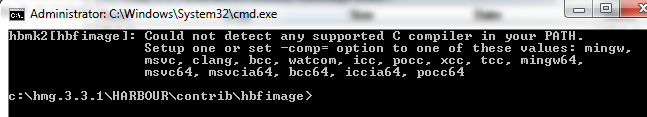

Dear Masters,
There are alot of harbour\contrib programs and samples,
like the hbfimage, but i cant compile with the build.bat
from the hm 3.3.1... Pls help and advise how to do it...

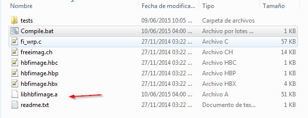

Re: Running harbour\contrib\hbfimage\test
Posted: Wed Jun 10, 2015 11:57 pm
libhbfimage.a es creado a partir de la ejecucion de compile.bat
es raro pero la descarga de los sources desde Github trae hbfimage.hbp
libhbfimage.a is created from the execution of compile.bat
It is rare but downloading the sources from Github brings hbfimage.hbp

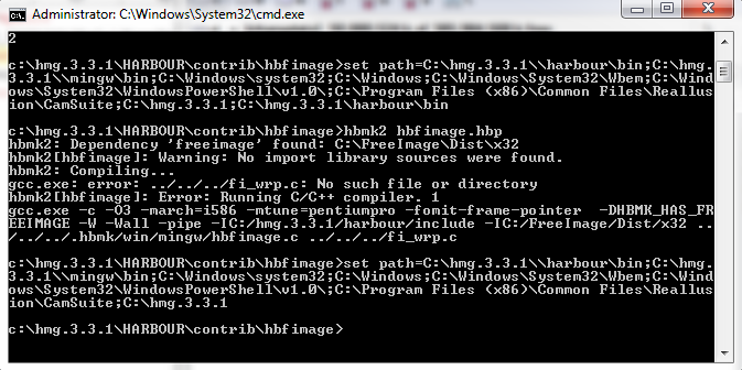

Posted: Thu Jun 11, 2015 9:55 pm
by hmgchang
Thks Mr. Daniel,
but getting this after compile :
Pls advise...
TIA

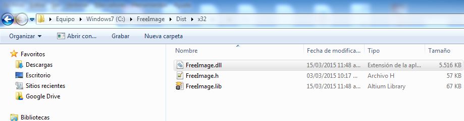

Posted: Thu Jun 11, 2015 10:29 pm
exists freeimage.dll in \dist\x32 folder ?
