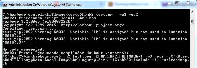

Re: Running harbour\contrib\hbfimage\test
Contiene un error Warnning W0032 que corresponde a la linea 51 y 53
im := fi_Load( FIF_JPEG, IMAGES_IN + "nothere.jpg", JPEG_DEFAULT )
todavia no encontre el error de codigo.

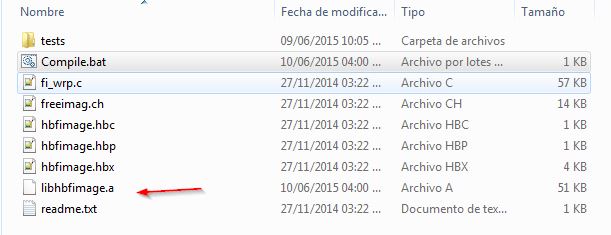

libhbfimage.a es creado a partir de la ejecucion de compile.bat
es raro pero la descarga de los sources desde Github trae hbfimage.hbp
libhbfimage.a is created from the execution of compile.bat
It is rare but downloading the sources from Github brings hbfimage.hbp
code in hbfimage.hbp

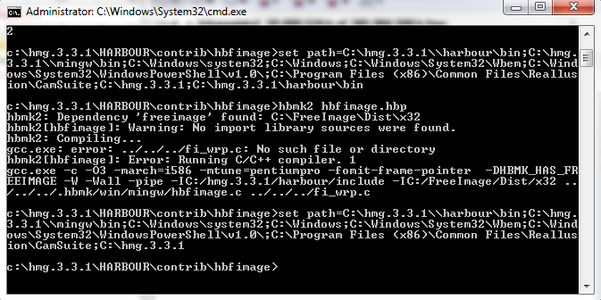

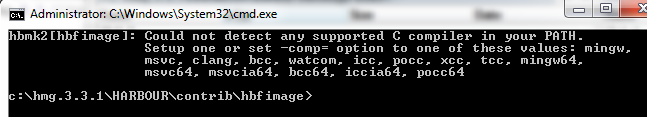

Thks Mr. Daniel,
but getting this after compile : Pls advise...
TIA
TIA
Just Hmg It !

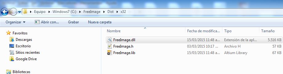

exists freeimage.dll in \dist\x32 folder ?
http://sourceforge.net/projects/freeimage/
