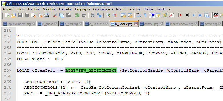

Hi Dr. Claudio,
There is a mismatch of value in _GridEx_GetCellValue function where all cItemCell is character type due C function LISTVIEW_GETITEMTEXT.
- Screen2.png (35.32 KiB) Viewed 5653 times
In order to get the right value of CHECKBOX return (actually wrongly returning NIL), I suggest to replace this:
IF ALLTRIM(HMG_UPPER(cItemCell)) == ALLTRIM(HMG_UPPER(ALABELS [1]))
xData := .T.
ELSEIF ALLTRIM(HMG_UPPER(cItemCell)) == ALLTRIM(HMG_UPPER(ALABELS [2]))
xData := .F.
By this one:
ELSEIF AEC == 'CHECKBOX'
IF ALLTRIM(HMG_UPPER(cItemCell)) == ".T."
xData := .T.
xData := .F.
Or if you find a better way converting in logical type probably is more safety.
I hope to had been helfully.

Pablo César wrote:Hi Dr. Claudio,
xData := .T.
xData := .F.
By this one:
xData := .T.
xData := .F.
Done!
You are right, in CHECKBOX is allow a binary value, .T. or .F., in the original rather than ElseIf should be only Else.
Thanks Pablo.
