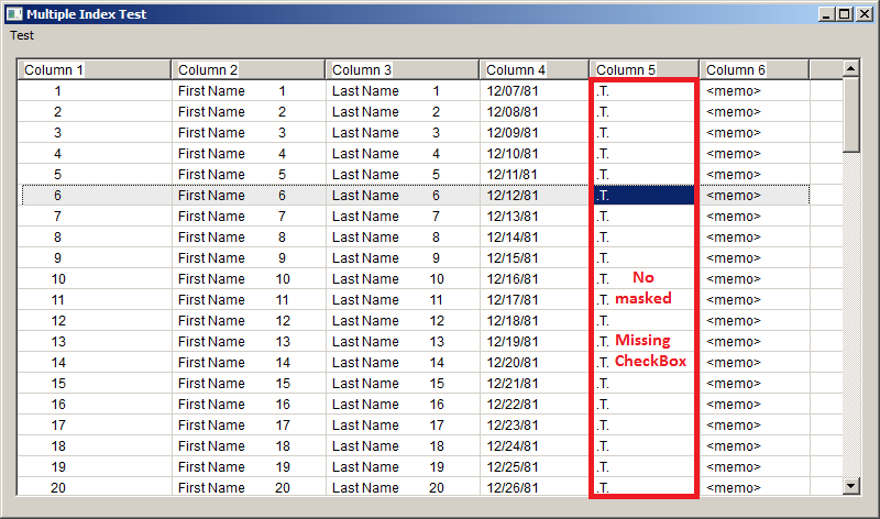

Hi HMGDT and all,
I found something strange and I'm in doubt regarding CheckBox in ColumnControl.
It is not being displayed as masked column (even with ColumnControl defined) in RowSource Grids.
For samples at 31,32,33,34,35,36,37 and 38 RowSource Grid demos, are not working the right displaying.
See picture below:
As you can see, in this example is not be displayed "yes"/"No" :(
By the other side this behaviour is different with grid of arrays.

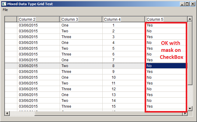

See this picture is from C:\hmg.3.4.0\SAMPLES\Controls\Grid\GRID_09:
But in this case is displaying a masked column (Yes/No) according CheckBox at column 5 by returning when COLUMNCONTROLS is defined in grids with arrays.

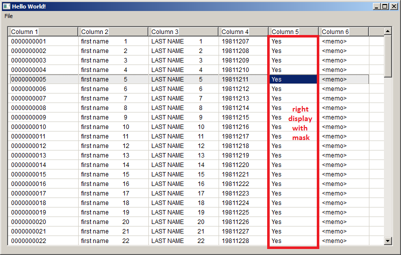

What I also saw that in C:\hmg.3.4.0\SAMPLES\Controls\Grid\GRID_30 demo that's displaying normally, because this demo is working with RowSource but is beign done by DYNAMICDISPLAY. See picture below:
IMHO ColumnControls should it should be available in the same way even being RowSource grid and not only for arrays.
This could be this could be standardized it ?
Because we can use DYNAMICDISPLAY in RowSource Grids only. :(

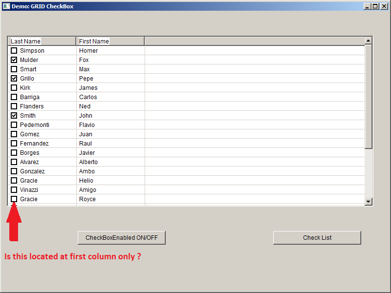

I have these questions about the new select item(s) in Grid as a kind of checkbox:
  1. Working only at first column ?
  2. I'm in doubt to define this new select item, which I supose when is filled/cheked is for the first column propose or be for all fields (selecting all columns) ?
  3. For InputWindow edition: Should I put as a first control ? What label for that ? Record selected ? No label at all ? Or I should it put together with the first column as a caption ?
Please see this picture below. Is it this normal ?
Would OnCheckBoxClicked occupying another Grid property ?
I was asking to myself: For what's this new select item used for ?
And I got it. It's selectable items at Grid when we have no a logical field as specific for selection. Great ! :D

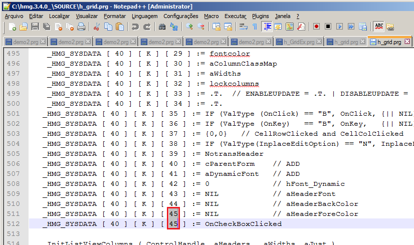

CheckBox is available only in the first column and always is a sub-item of the first column.
You are right, the index of OnCheckBoxClicked is 46, I fixed it.

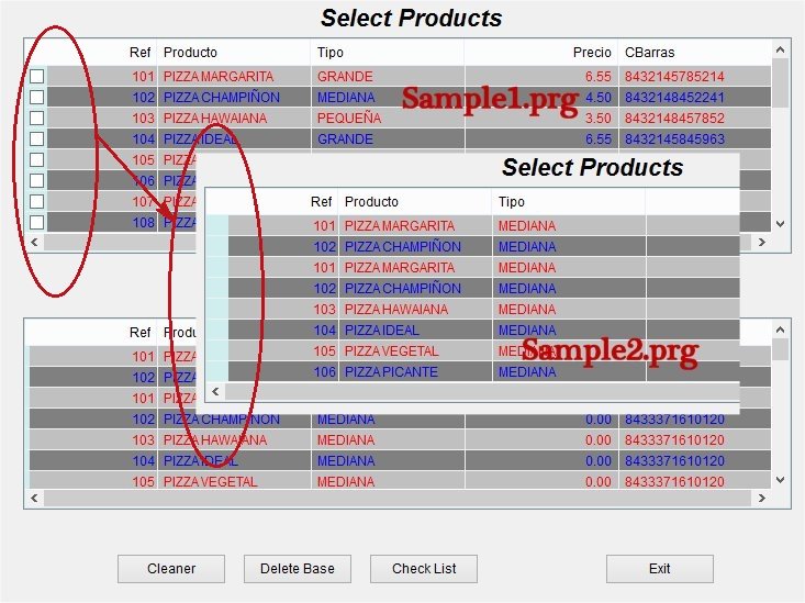

Hola amigos:
Tengo un problema , estoy experimentando con "CheckBoxEnabled"
he modificado el sample que está: c:\hmg.3.4.0\SAMPLES\Controls\Grid\Grid_CheckBoxes
en "sample1.prg" el Grid_1 tiene ARRAY (25), no databases y sale perfecto los
CheckBox y un vez seleccionado mediante el Button "Check List", se incorporan al
Grid_2 que este si tiene un base de datos "STOCKP.dbf" , con Button "Cleaner" dejamos
limpio Grid_1 de CheckBox y Button "Delete Base" Borramos la base de datos "STOCKP.dbf"
de Grid_2, todo perfecto.
el problema está en "sample2.prg" que se ha sustituido en Grid_1 los ARRAY (25), por
base de datos "STOCK.dbf" pero no sale CheckBox y claro no se puede seleccionar nada
y si le das al Button "Check List" copia toda la base de datos sin poder hacen ninguna
selección.
Alguien me puede solucionar el problema de "sample2.prg" ?
Muy agradecido por su atención

mustafa wrote:el problema está en "sample2.prg" que se ha sustituido en Grid_1 los ARRAY (25), por
Parece haber algun problema cuando es ROWSOURCE... :?

Hola Pablo Cesar :
Mira el sample2,prg en el Zip -> Demo_CheckBoxEnabled.zip que he mandado
el sample1,prg funciona perfecto, pero el sample2.prg tiene un DBF y creo que
yo no se detectar el fallo.
Personalmente no domino mucho la técnica de los Grid. me esta pasando en muchos
samples cuando pasas de las Bases Virtuales ( ARRAY ) a las bases de datos verdadera
es decir fichero DBF no siempre reaccionan igual los samples .
Muy agradecido por tu atención, haber si puedes dedicarle un instante y ver si
tiene solución, creo que seria interesante esta nueva función "CheckBoxEnableden" en los Grid
