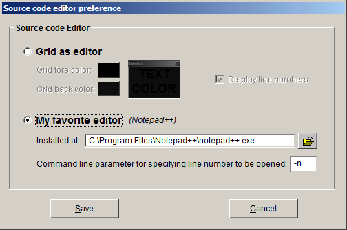

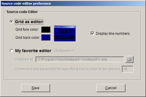

But making tests with FontColor:=BLACK and BackColor:={0,0,128} (dark blue), I got following results:
With your last code ( nGray := INT ( (aBackColor[1] * 0.299) + (aBackColor[2] * 0.587) + (aBackColor[3] * 0.114) ) ):
With my first example ( nGray:=(aColor[1]+aColor[2]+aColor[3])/3 ):
I know that colors BLACK with DARK_BLUE is no ideal for editing source. But if I give chance to user for changing, I need to do it in better results.
It's strange to see the difference and I made many other combinations, perhaps I saw this formula INT ( (aBackColor[1] * 0.299) + (aBackColor[2] * 0.587) + (aBackColor[3] * 0.114) ) ) in many C codes but maybe for images ? I don't know.
