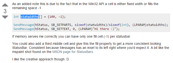

I found this in code C# for right align text. I do not know how to do it in C and for center aligment:

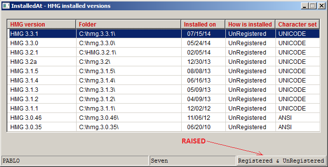

The problem is when one or more item is RAISED style.
When by ACTION we need to change it text, then worngly the item changes the style :o
I mean, changes from RAISED to FLAT... :(

Pablo César wrote:I come here to say there is a litle bug around SetStatusItemText() at c_status.c.
Hi Pablo,
change in file c_status.c the original SETSTATUSITEMTEXT() function for this:
HB_FUNC (SETSTATUSITEMTEXT)
   TCHAR * text = (TCHAR *) HMG_parc(2);
   WORD nDraw = HIWORD ( SendMessage ((HWND) HMG_parnl (1), SB_GETTEXTLENGTH, (WPARAM) hb_parnl (3), 0) );
   SendMessage( (HWND) HMG_parnl (1) , SB_SETTEXT , (WPARAM) (nDraw | hb_parnl (3)) , (LPARAM) text ) ;
Align text to Center in StatusBar
Posted: Wed Dec 24, 2014 10:26 pm
Perfecto ! :D
Thank you Claudio, you are great ! Now RAISED style is respected as accordingly, thanks to you ! :)

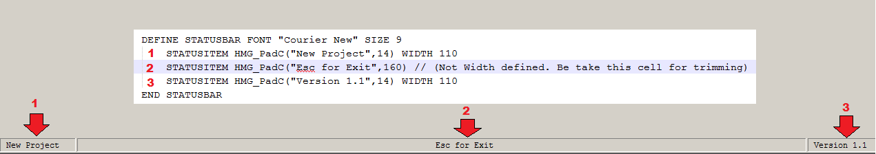

  1. Is it posible to set text at StatusBar's items to be aligned to center ?
    Like as to include at anWidths:={ LEFT, CENTER, RIGHT}
  2. StatusBar when there is more than on item, always it takes the first cell at most left for trimming propose.
    Is it posible to expand as possibilities selecting which cell it could be used for trimming ?
    I've got an idea and I make some test already by changing StatuBar in our library with three options:
    1. When just one of cell is Nil Width size.
      It will take this cell for trimming.
    2. When all Width sizes are defined.
      It will take the bigger width size cell for trimming.
    3. When all Width sizes are equally.
      It will take the first cell for trimming, as ever done.

      I propose to change as follows:
      Local nMaxWidth:=0
      Local aNil:={}
      Local nP:=1
      	For i := 1 To HMG_LEN (anWidths)
      		If ValType ( anWidths [i] ) <> 'N'
      			anWidths [i] := 120
      			Aadd(aNil,i)
      		EndIf
      		If anWidths[i] > nMaxWidth
      		   nMaxWidth := anWidths[i]
      		   nP := i
      		Endif
      		nTotWidth := nTotWidth + anWidths [i]
      	Next i
      	If HMG_Len(aNil)=1
      	   nP := aNil[1]
      	ElseIf HMG_Len(aNil)>1
      	   nP := 1
      	Endif
      	nTotWidth := nTotWidth - anWidths [nP]
      	anWidths[nP] := GetWindowWidth ( nParentHandle ) - nTotWidth
      As you can see three options wil be considered for trimming.
As it's now for trimming widths cells at first cell, it's quite imposible to adjust midle cells... :(
By this way midle cell will be easy let with width size for trimming. Specially when we have different screen resolutions.
I'm asking these features in order to leave more versatile StatuBar control.

    Is there any other way to do it ? I saw something like Add a ToolstripLabel to the StatusStrip (but I do not know how to do it... :oops:
