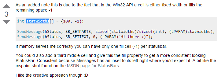

I found this in code C# for right align text. I do not know how to do it in C and for center aligment:

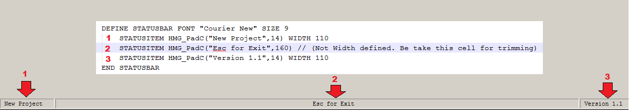

I used the Courrier New (monospaced font) with PADC. But sometimes we do not know how long in characters would it can be applied for StatusBar when Window is not fixed sizes.

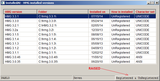

The problem is when one or more item is RAISED style.
When by ACTION we need to change it text, then worngly the item changes the style :o
I mean, changes from RAISED to FLAT... :(

    I've got an idea and I make some test already by changing StatuBar in our library with three options:
    1. When just one of cell is Nil Width size.
      It will take this cell for trimming.
    2. When all Width sizes are defined.
      It will take the bigger width size cell for trimming.
    3. When all Width sizes are equally.
      It will take the first cell for trimming, as ever done.
