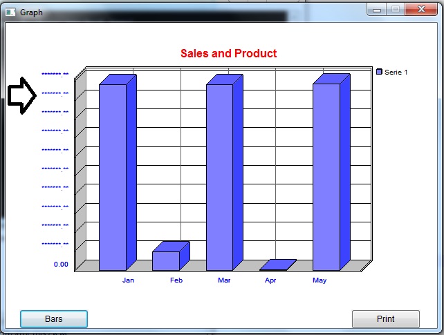

Como corrijo una gráfica?
En las gráficas de barras salen asteriscos en vez de cantidades, cuando las cantidades son mayor a 1,000,000.00, que se tiene que hacer para solucionarlo, ya trate de encontrar algo en el foro pero no lo encontré.
Saludos y gracias por la atención que tengan a este post.
As I edit a graph?
In the bar charts depart asterisks instead of numbers when the numbers are greater than 1,000,000.00, you have to do to fix it, and try to find something in the forum but not found it.
Greetings and thanks for the care you have for this post.

Hi Javier,
It is a known limitation in the Graph source and there is a simple workaround for it.
Please take a look for an updated sample below:
Local aSer:={ {12314280,1220420,12312870,25347, 12347640} }
Local serie
For each serie in aSer
	For i:=1 To Len(serie)
		serie[i] := aSer[1][i] / 1000
	Next
Next
	Define Window GraphTest ;
		At 0,0 ;
		Width 640 ;
		Height 480 ;
		Title "Graph" ;
		Main ;
		Nomaximize ;
		Icon "Main" ;
		BackColor { 255 , 255 , 255 } ;
		On Init DrawBarGraph ( aSer ) ;
		Define Button Button_1
			Row	415
			Col	20
			Caption	'Bars'
			Action DrawBarGraph ( aSer )
		End Button
		Define Button Button_4
			Row	415
			Col	500
			Caption	'Print'
			Action PRINT GRAPH OF GraphTest PREVIEW DIALOG
		End Button
	End Window
	GraphTest.Center
	Activate Window GraphTest
Procedure DrawBarGraph ( aSer )
	ERASE WINDOW GraphTest
	DRAW GRAPH							;
		IN WINDOW GraphTest					;
		AT 20,20						;
		TO 400,610						;
		TITLE "Sales and Product (in thousands)"		;
		TYPE BARS						;
		SERIES aSer						;
		YVALUES {"Jan","Feb","Mar","Apr","May"}			;
		DEPTH 15						;
		BARWIDTH 15						;
		HVALUES 10						;
		SERIENAMES {"Serie 1"}		;
		COLORS { {128,128,255} }	;
		SHOWGRID                        			;
		3DVIEW    						;
		SHOWXVALUES                     			;
		SHOWYVALUES                     			;
		SHOWLEGENDS 						;
		NOBORDER

gfilatov wrote:Hi Javier,
If Gregory Filatov had already done that and put in place of "Series Name" put ("Quantity X 1.000"), but does not look very professional. I hope there will soon be a better solution.
Thanks for the attention.
Si Gregory Filatov, ya había hecho eso y poner en lugar de "Nombre de la serie" poner ("Cantidades X 1,000"), pero no se ve muy profesional. Espero que pronto haya una mejor solución.
Gracias por la atención recibida.

Javier Tovar wrote:...
Hi Javier,
You are right! Therefore Minigui Ext have a 'DataMask' clause in the Draw Graph command.
You can see a correct result for DATAMASK "99,999,999" on this screenshot below.
