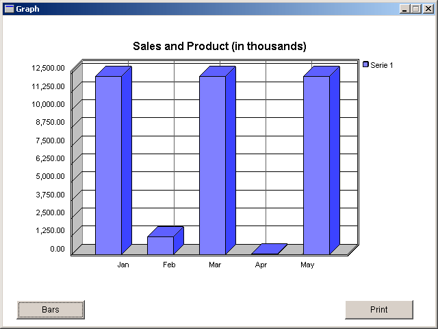

Hi Javier,
It is a known limitation in the Graph source and there is a simple workaround for it.
Please take a look for an updated sample below:
Local aSer:={ {12314280,1220420,12312870,25347, 12347640} }
Local serie
For each serie in aSer
For i:=1 To Len(serie)
serie[i] := aSer[1][i] / 1000
Next
Next
Define Window GraphTest ;
At 0,0 ;
Width 640 ;
Height 480 ;
Title "Graph" ;
Main ;
Nomaximize ;
Icon "Main" ;
BackColor { 255 , 255 , 255 } ;
On Init DrawBarGraph ( aSer ) ;
Define Button Button_1
Row 415
Col 20
Caption 'Bars'
Action DrawBarGraph ( aSer )
End Button
Define Button Button_4
Row 415
Col 500
Caption 'Print'
Action PRINT GRAPH OF GraphTest PREVIEW DIALOG
End Button
End Window
GraphTest.Center
Activate Window GraphTest
Procedure DrawBarGraph ( aSer )
ERASE WINDOW GraphTest
DRAW GRAPH ;
IN WINDOW GraphTest ;
AT 20,20 ;
TO 400,610 ;
TITLE "Sales and Product (in thousands)" ;
TYPE BARS ;
SERIES aSer ;
YVALUES {"Jan","Feb","Mar","Apr","May"} ;
DEPTH 15 ;
BARWIDTH 15 ;
HVALUES 10 ;
SERIENAMES {"Serie 1"} ;
COLORS { {128,128,255} } ;
SHOWGRID ;
3DVIEW ;
SHOWXVALUES ;
SHOWYVALUES ;
SHOWLEGENDS ;
NOBORDER
- Correct graph
- screen.png (7.16 KiB) Viewed 4172 times

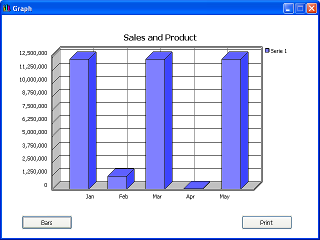

Hi Javier,Javier Tovar wrote:...
but does not look very professional. I hope there will soon be a better solution.
Thanks for the attention.
You are right! Therefore Minigui Ext have a 'DataMask' clause in the Draw Graph command.
You can see a correct result for DATAMASK "99,999,999" on this screenshot below.
- scrshot.png (13.9 KiB) Viewed 4066 times
