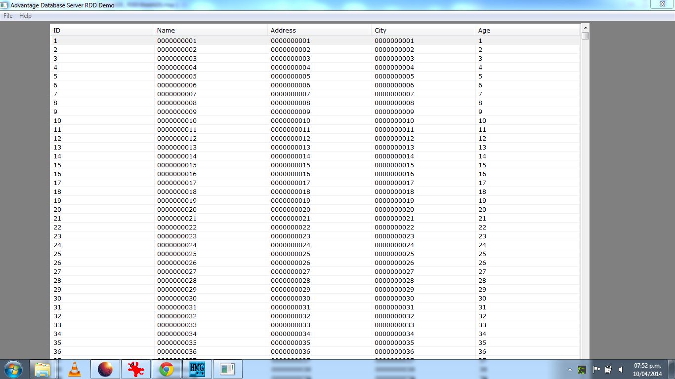

Re: ADS con HMG
Posted: Thu Apr 10, 2014 10:53 pm
2014-04-10 19_52_35-Advantage Database Server RDD Demo.jpg (173.68 KiB) Viewed 2755 times
