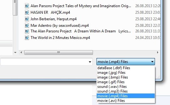

I guess acFilter parameter of GetFile() function may meets your need ( at least a portion ) ;)
Screenshoot of GetFileTest.prg
GetFileTest.zip
Source files of GetFileTest
(843 Bytes) Downloaded 307 times

quartz565 wrote: What I mean though is:
As far as know, GetFile() function of HMG calls GetOpenFileName() of Windows API.
So, "List View" is normal behavior of Windows.
"View menu" and other views are features of Windows Explorer, not sub-functions.
Maybe an expert would develop a solution for your request.
Anyway you would think develop your own GetFile() function.
When done please share with us.
